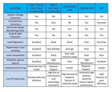

For stabiliser
1. Static - No moving parts, Expensive and high repair/service cost.
2. CVT - No moving parts, conventional, fix and forget type.
3. SERVO - Cheapest per kVA, moving parts needs service. Cheap spares.
For power backup
1. Ordinary Line interactive UPS is sufficient.

For stabiliser
For power backup
I am no expert on stabilizers but have read that CVT is not very accurate. The electrical experts in the forum can throw more light on this.
Servo stabilizers have moving parts which may perhaps need to be serviced after prolonged periods. They are not as fast as static stabs. Besides they make a short belching/beeping kind of sound during voltage correction. Certain servo stabs come with the emi/rfi filters.
IGBT static stabilizers are the fastest in correction with no moving parts and very silent. But the flip side is that they are very expensive. They are generally used for sensitive equipments. Certain static stabs come with the emi/rfi filters.
