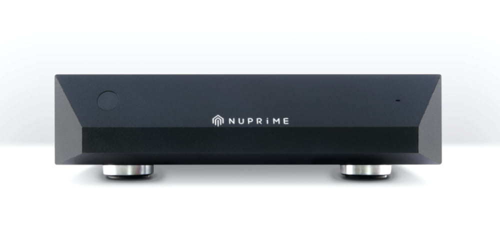

Benchmark abh2
Do consider nuprime st-10.
I have heard the benchmark, and though it is very good I preferred the nuprime as a better vfm option. Pair it with a tube pre and it will do both the lushness of tubes with the slam of solid state. I owned 1 for about a year and thoroughly enjoyed it.
