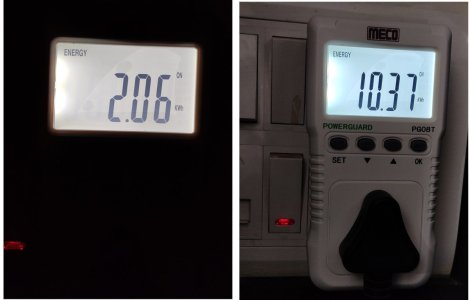

1st image : at the end of Watching one episodes of Mandalorian and Picard.
2nd image : at the end of few Episodes of Mandalorian and The Night Agent. ( could be about 6-7 hrs) .

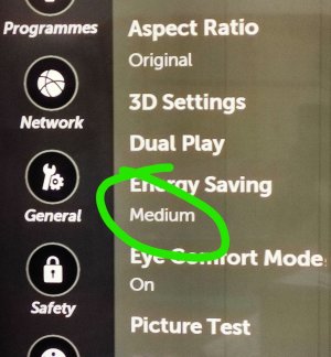

AVR 2310 in 7.0 ( sub is on different point ) + 65" lg ( on medium energy setting , on full, it may be another 3+ units )

Also, Read somewhere, Dolby vision / HDR 10+ the energy consumption can be more.
- I did not check - though prime stick is set to use HDR always ( a bit brighter even in medium Energy settings )
