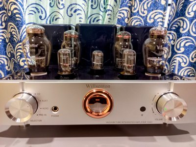

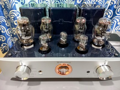

After a month wait finally Willsenton r300b arrived yesterday. It's unbelievable how good the craftsmanship is for the price. It's damn heavy at 25KG. Its huge amp.
Pairing it with a loaner Harbeth SHL5 which are 86DB, that 8 watts are driving the speakers with authority. Low end is amazingly good.
Little disappointed that I am not getting midrange sweetness (could be speakers as well) need to give some time for tubes to settle in.
Overall great 300B SET amp for the price.

View attachment 73960View attachment 73959
Gorgeous!
Do post your listening impressions once the amp has settled in.
Also, trust you have re-seated the tubes and calibrated the bias? That would take care of any jolts they may have experienced on the way over to you.
Happy listening! :)
Is 8 watts sufficient to drive Harbeth?
Yes. Its class A 8 watts. Gets plenty loud by 10am position
Happy listening! :)
Thanks for reminding. I just did biasing.

Pretty looking !!. The amps dead-center middle input tube should have been positioned two inches forward, to get that most sensitive input stage farther away from the power supply fields, happening in the rectifier tubes. RCA input jacks, also should be center top-plate front positioned.
You need 100 Hours as a minimum, to as many as 800 hours, to fully break in such an amplifier.
I like those dual 5U4GBs, something I went to in 1989 and again use from 2019 going forward. Tip, try out Russian Electro Harmonix 5U4GBs.
I wish I would have seen this thread earlier. I would have advised you to consider a LAB 12 300B amp from Athens, Greece. ( see Steve Guttenberg and Herb Reichert on-line videos ). It is cost - effective, a simpler circuit - a two stage amp. One less stage outplays three tube stage tube amps when all else is equally well executed. Well, just give your's some break in time now.
Tube rolling will help some, but only after break in !!! Replacing all plate and cathode resistors, with same value Roderstein MK8s, from Michael Percy in the USA, should greatly help that amp's sonics. ( timbre and purity-wise ). Also below deck, cut-out all tie wraps, discard them, and spread wires 1/8th an inch or more from each other. That will sound somewhat nicer.
Can you post the amp's schematic for us who are so inclined?? If not provided, DO get one now, for servicing the amp locally n future years.
You could make up the 9.52 feet long speaker wires from HFV's M22759 Speaker Cable Thread. These have not been bested, so far in A-Bs !!! While you are at it, make the 300B amp's power cord wires 9.52 feet m22759/11/12 also, as it will sound perhaps about one to three percent nicer also. A triode tube amp such as a 300B can be a direct access to the music device. Have fun listening.
