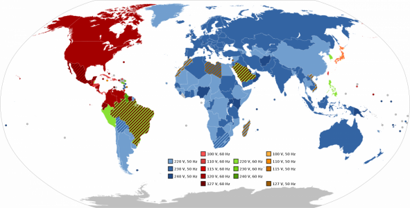

No way to change the frequency unless the whole grid changes :cool: .Majority of the world is in 50Hz club. Some in 100-110V 50Hz and one or two in 230V, 60Hz even :oops:
XBox and such have SMPS in the brick that does not mind the frequency.
The way to do in my opinion is to get an converter - inverter setup that outputs 120V, 60Hz. You convert 230V, 50Hz to DC and back to 120V, 60Hz.
