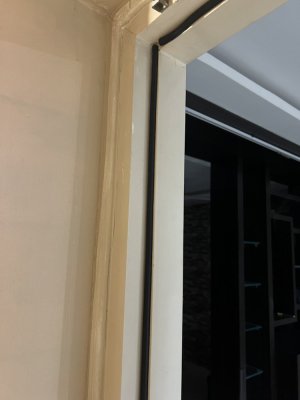

I got mine today. Now not able to close door properly.
They are too thick to directly put in between the hinge. Try them on the door corners that face the door instead of hinge so that only half of it goes in and makes a seal.
But yeah, they do make a seal but I've yet to test it completely. (My wooden door has joints where sounds leak so I'll test it on a flush door)

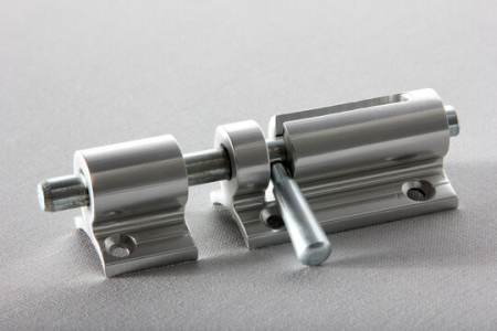

Also the latch ring @Yelamanchili manohar mentioned would be an awesome addition to further ensure the door stays shut on top.

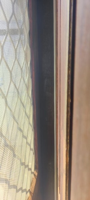

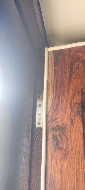

This trick worked, but still, I had to add the seal on only two sides of the door. Not sure of soundproofing but it helped in reducing door rattle completely during bass-heavy movie scenes.
They come with really bad adhesion. Mine tends to come loose on the corners. You can also try using double without splitting the ends. Or one on either side.
