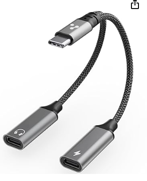

With a minor DIY you can use a cable like this. The usb cable with the headphone end goes to your PC and the one with lightning symbol goes to the LPS.

Thank you. That is a brilliant idea. Will try to get that cable.

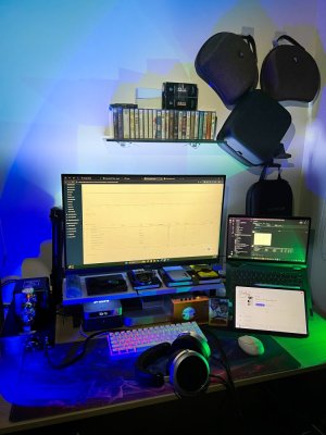

I am using FiiO K11 R2R for past few months for my desktop setup, it sounds phenominal for the price.
Smooth and musical dac. The headphone out is decent too.
Currently using Mac Mini M2 with Roon + HQplayer via USB to FiiO K11 R2R > Darkvoice Tube headphone amp > HD650 or HifiMan 400se.
