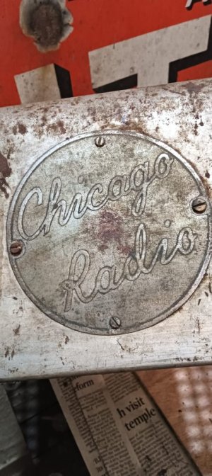

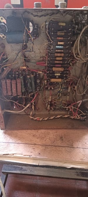

Hello,
I'm trying to restore a vintage Chicago Radio Tube amplifier (mostly used as a PA system). Presently, it has on its chassis a ECC83 pre amp and NEC valve (details not visible) in the amplifier stages. The amp is mostly intact except someone has changed the power stage from tube to diode (IN4007). I did send a message to Motwani communications (Present name of Chicago Radio) but no reply from them. What I need is more info on this amp and if possible any schematic. I want to restore it back to original specs.
Thanks

I would recommend to check power and audio output transformer to see if they are working or not. Good transformers will increase your budget significantly in restoration.
regds.
Addition : Also if this is PA amplifier system. there are good chances of its audio output transformer will be band limited. So dont go for specifications just see if it can be restored as a working amplifier.
Iron seems to be completely rusted so no point working on it. 5881 tubes ?Chicago iron is well regarded and particularly for Push Pull circuits.

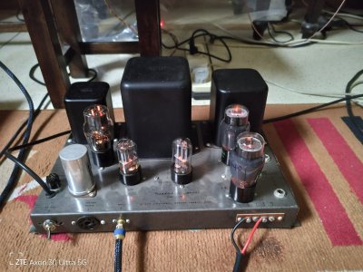

I restored and fired mine recently, a mono 6L6 PP amplifier which doesn't sound an iota like a PP but SE. It's a Heathkit W4 AM based on all Chicago iron. Excellent sound.

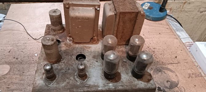

Some update: We connected the amp to mains using a pilot bulb and it seems to work fine with and without the pilot. So no shorting or anything and the tubes lit up fine. Components are, IMO, quiet OK. My guess is that there is separate preamp for tone and audio, IMG20251107075756.jpg
Although i'm not sure. We have bought the caps and knobs recently. I'll keep the thread updated.
