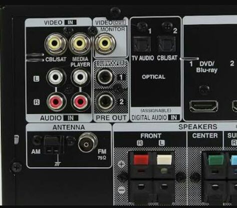

Really silly question....but trying to understand if I can make my denon 520BT into a power or Preamp with the existing connections at the back for more quality and power.
Is there a way?
Can I use it/ convert it/ make it more powerful by adding another power or preamp?

Nope.. You can't use the Denon as Pre-map as there are no pre-outs for any channels other than sub-out.. You can't use it as power amp too..

An amp that has split preamp and power amp section will typically have a removable U link connecting the preamp section to the power amp section.
To use it as a preamp driving another power amp, simply remove the U link and take the output from preamp and connect it to external power amp.
To use the power amp section, remove U link and drive the power amp section from an external preamp.
If U link is missing it means the connection from preamp to power amp is internally hardwired.
No unfortunately this denon cannot be used as pre or power amp.
