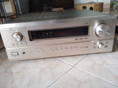

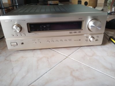

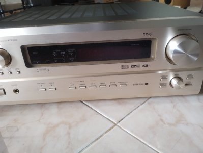

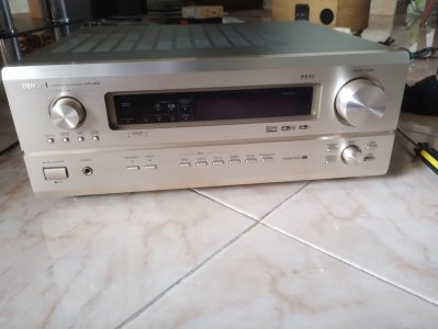

Lots of maintenance from my end. Regular internal cleaning and dusting. Checking for cockroach or other kinds of infestation. Running it for 5-6 hours tops and then minimum 1 hour rest etc. Runs through a CVT. Volume never increased beyond -45 etc. :)
My clean up yesterday of my ole Denon AVR 3803. :)

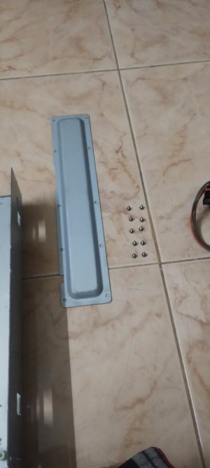

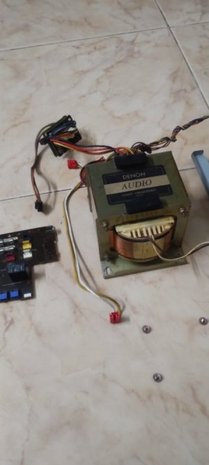

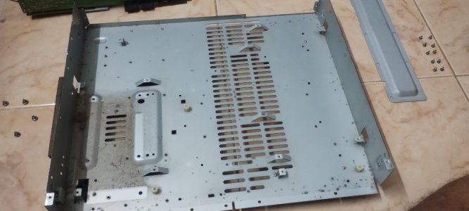

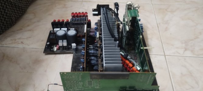

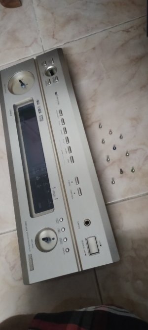

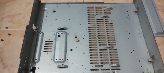

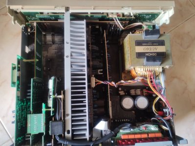

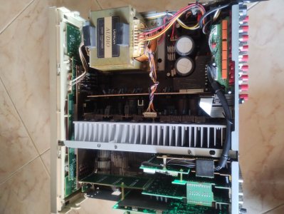

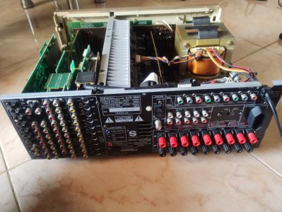

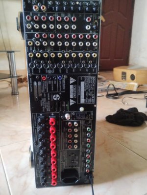

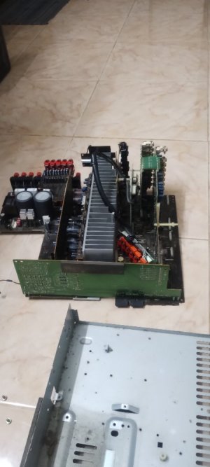

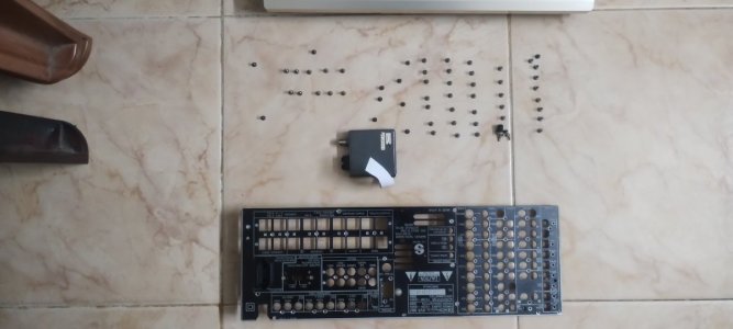

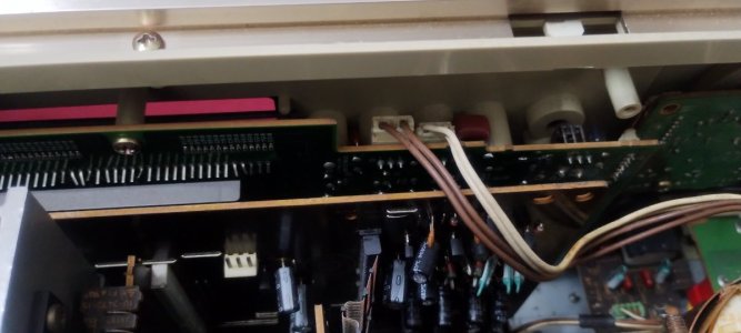

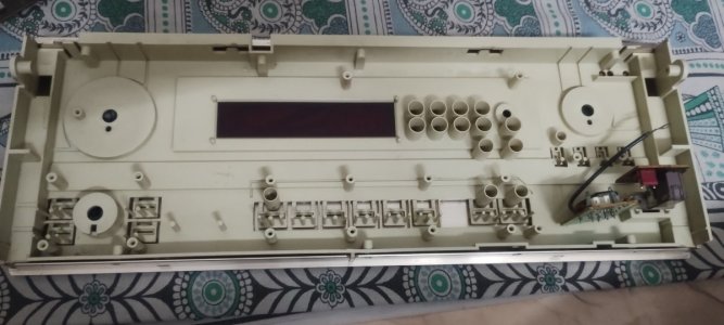

My usual service of Denon AVR 3803. This time all boards were removed and individually cleaned up using Isopropyl alcohol and every component was checked for damage or dry solder. Absolutely no dry solder was seen. Aluminium chasis was cleaned with light soap water and wiped dry. The whole process took from 7/12/2025 6:45 pm until 3:15 am Saturday morning. :)
Om 8/12/2025 only the front panel was dismantled and cleaned.
Refitted on Sunday morning and checked. Working fine so far.
Take aways : was full of dust, cow webs and dead spiders. Boards were beginning to dirt and were beginning to affect components. So cleaning helped.
Would recommend it if you have patience and the will to take failure as part of this game. Photos attached for your reference:
