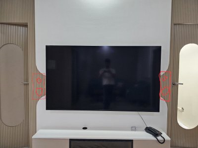

I have a TV in the drawing room wall which has very less space for a proper bookshelf speakers.

Planning the mount the Elac in the area marked in red:

Thanks, I'm also considering on-wall aspect of the Elac OW4.2, which given the low depth will be ideal for my setup, it won't cause any disturbance while using the doors at both sides of the TV (shown in the image).
Do you think it will be a good tradeoff to loose the convenience of on-wall of OW4.2 and go with proper bookshelf for better sound, will the sound be better by very high margin?
