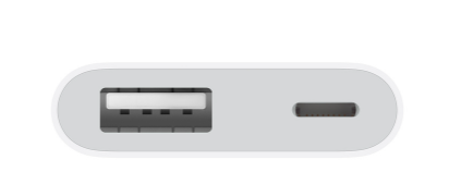

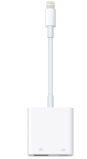

I also wanted to exploit the full 24/192 of the Schiit Modi +. After some reading on the net, I came across the Lightning to USB3 connection kit from Apple. Its quite expensive for being just a connector- INR 4,000 being the MRP.
Schiit Audio recommends it for connecting their DACs to the iphone.
As per Audioquest as well, it is better to use this version of the adapter (USB 3) rather than cheap connectors to ensure bit perfect delivery of audio to the DAC. This connector also allows for parallel charging of iphones/ipads since it has 2 USB ports.

Thankfully the adapter worked flawlessly with the Schiit and the difference is quite startling. I noticed the retreival of smaller details, wider soundstage and the ability of music to now come from a space outside the speakers.
Its a huge step up from Airplay and the cheapest way to experience hi res from Apple. I use my apple watch to control the play list on the phone when it is physically connected to the DAC/amp thereby eliminating the inconvenience of getting up each time to change the track.

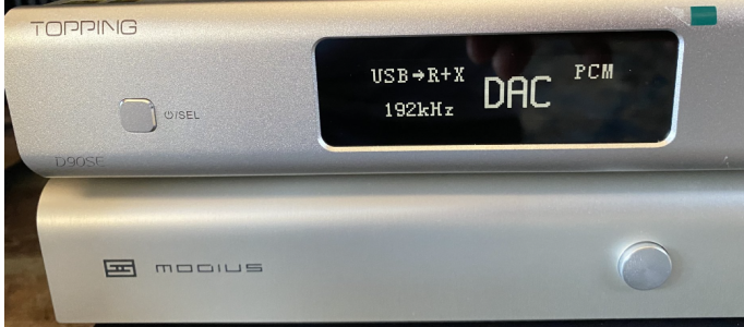

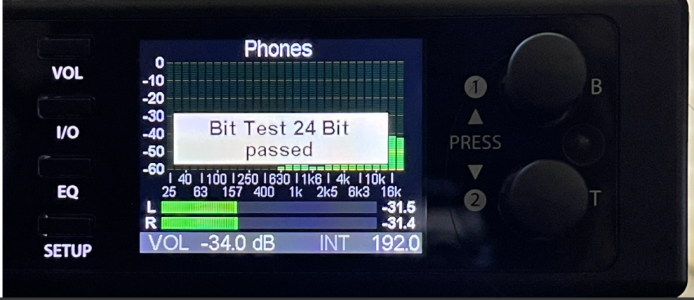

Here is a test which someone else conducted on ASR and posted with Apple music (from Ipad) and a lightning to USB3 connection kit. DAC used for testing was RME ADI-2
On a Topping:
On a Topping:
