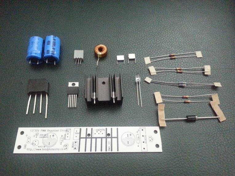

For Multi Purpose Power Supply,

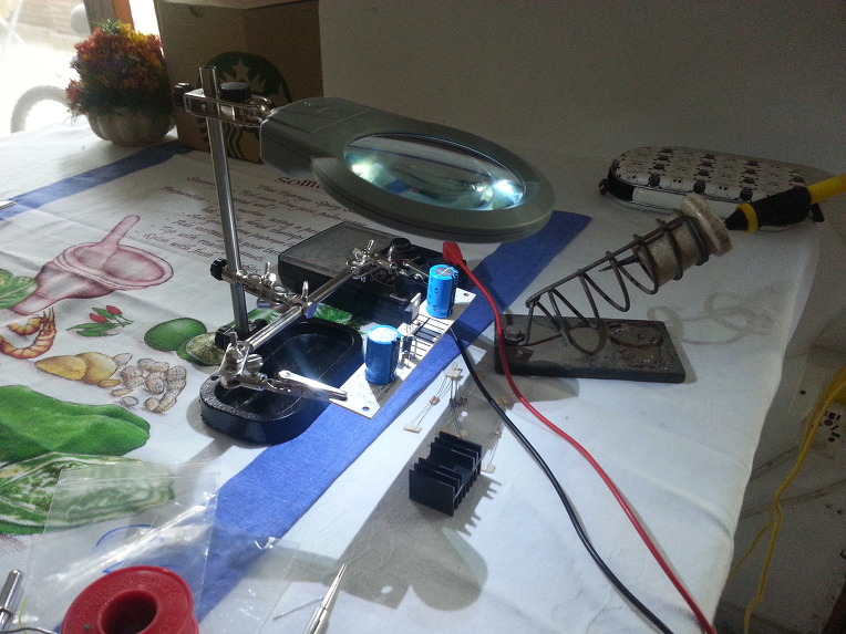

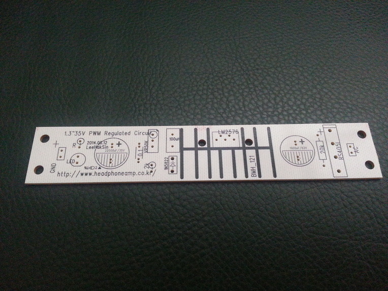

I am going to assemble LM2574 Regulated Power Supply.
This is the PCB
274FFF4253F5E74A2EF7AA

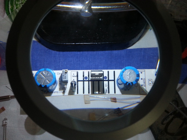

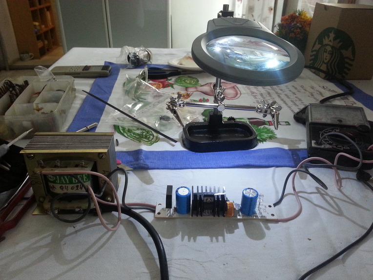

Completed!
It is only step down regulaltor.
24V input, 21V out supply is ready for Hybrid Headphone Amp

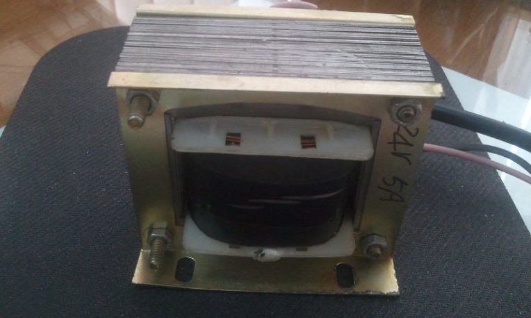

This trans gives lot of heat:sad:
Better go for Chinese Troidal Trans.
In kolkata's chadni chowk you can only get el traffo's . I already told you the cost, these are standard of the shelf product. There are other traffo provider's here too, like you said either they produce heat(a lot) or they(like in my case) generate a distinct odor.

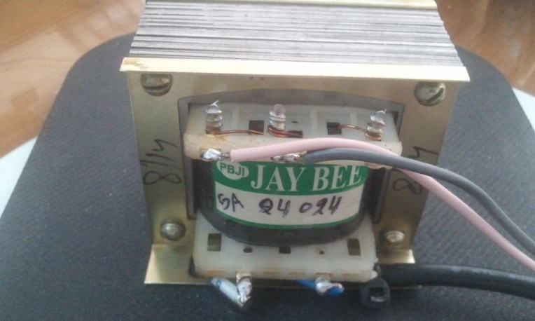

Trans : 5A X 2
Circuit : Max 3A
With loading (TPA 3116 Amp) : 1.5~2 A
I don't know why this trans gives heat with less loading.
Because to save copper its coils are bare minimum #turns in primary and ratio of primary:secondary maintained. So inductance is on lower side. The core material & stack build is putting lot of magnetic resistance to field and loss is dissipated into heat.
