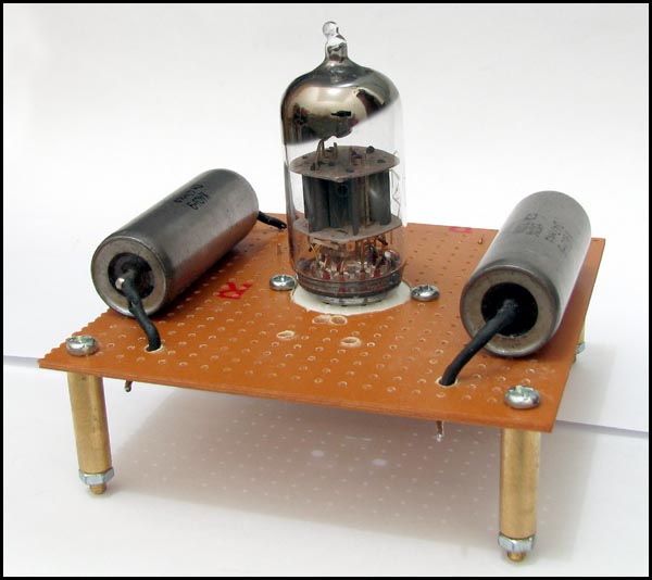

for the schematic : its some 5components /per channel
only one capacitor and all are MFR(metal film resistors )
Tubes in Qty of 8, russian NOS with shipping 20$ some 900Rs
6N1P VI Made in The USSR 6DJ8 ECC88 6922 Lot of 8 | eBay
Power it with 24-0-24v 1Amp Ei transformer
after rectification 30V dual supply you can get.
Per buffer will not cost >600Rs.

Even im in,but,wouldnt it be better to try a prototype before a GB goes through?I agree jimmy auw has tried it(the picture in the OP is his),but still..?
