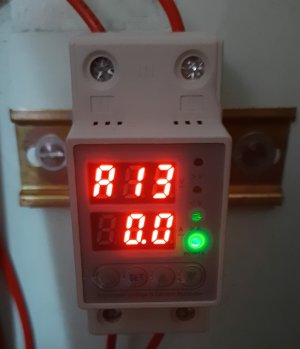

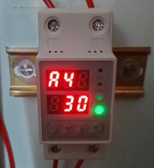

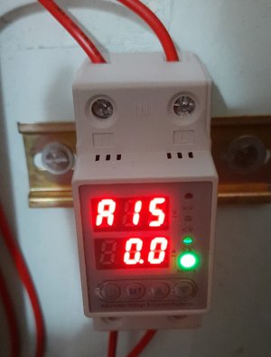

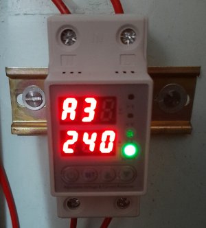

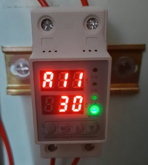

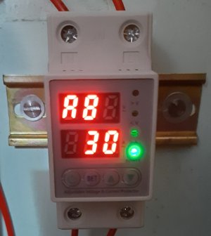

My amicikart voltage/current cut off device will arrive soon. Thanks for taking the time and patience to run through settings A1 to A15. It was a pleasure speaking with you earlier today.
A simple V Guard or another reputable brand of voltage stabilizer will do the job. They have a 3 minute delayed start plus they will cut power to the device once it drops below (Or higher) a certain threshold. You need to read the specification sheet to know what that is. I would not put a battery back up based solution for HT or any audio equipment.
That solves the voltage issue, but doesn't a sudden shut down affect the receiver? Or am I reading too much into this.

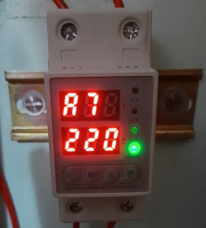

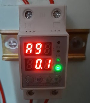

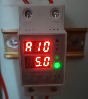

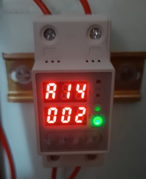

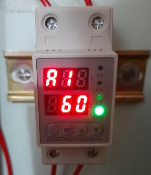

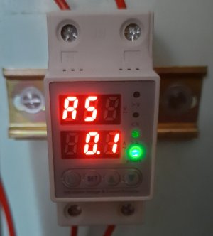

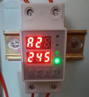

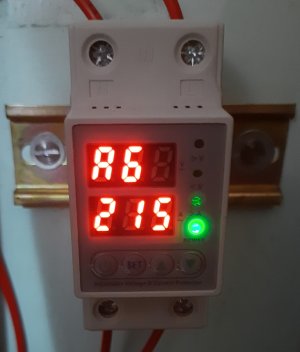

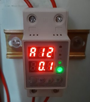

@mbhangui I installed the over-voltage/under-voltage/over-current device directly on the tv/hifi line and in the next few days we've had three over-voltage surges courtesy Adani. Thankfully this protector kicked in and saved the day! Sharing my settings so that anyone interested will get a rough idea. I have deliberately kept the voltage settings within a very restrictive range for my peace of mind.
A1 - POWER-ON DELAY TIME S
A2 - OVER-VOLTAGE PROTECTION VALUE V
A3 - OVER-VOLTAGE RECOVERY VALUE V
A4 - OVER-VOLTAGE RECOVERY DELAY TIME S
A5 - OVER-VOLTAGE PROTECTION ACTION TIME S
A6 - UNDER-VOLTAGE PROTECTION VALUE V
A7 - UNDER-VOLTAGE RECOVERY VALUE V
A8 - UNDER-VOLTAGE RECOVERY DELAY TIME S
A9 - UNDER-VOLTAGE PROTECTION ACTION TIME S
A10 - OVER-CURRENT PROTECTION VALUE A
A11 - OVER-CURRENT RECOVERY DELAY TIME S
A12 - OVER-CURRENT PROTECTION ACTION TIME S
A13 - VOLTAGE CALIBRATION
A14 - CONTINUOUS OVER-CURRENT FAULTS TIMES
A15 - CURRENT CALIBRATION
Just one question, any reason for this consistent over voltage in Mumbai since it is very often between 243 to 252 V.
