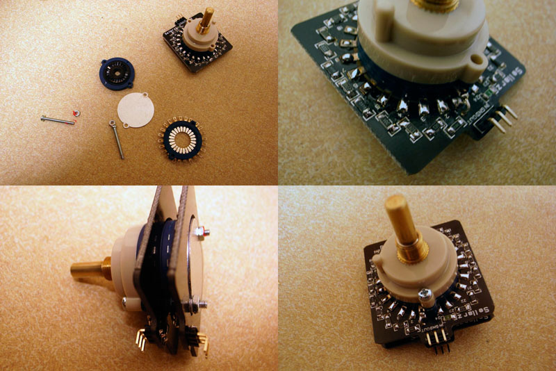

My DIY Ganeda Pre Amp has Alps Volume.
To make better sound, I got a 24 Step Sellarz attenuator (Made in Korea).
This kind of assembled attenuator Kit. (it is not mine)
4966fab0600e4
This is mine.

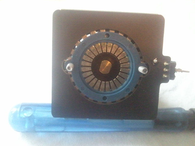

Inside of the attenuator

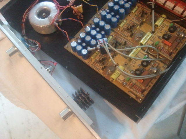

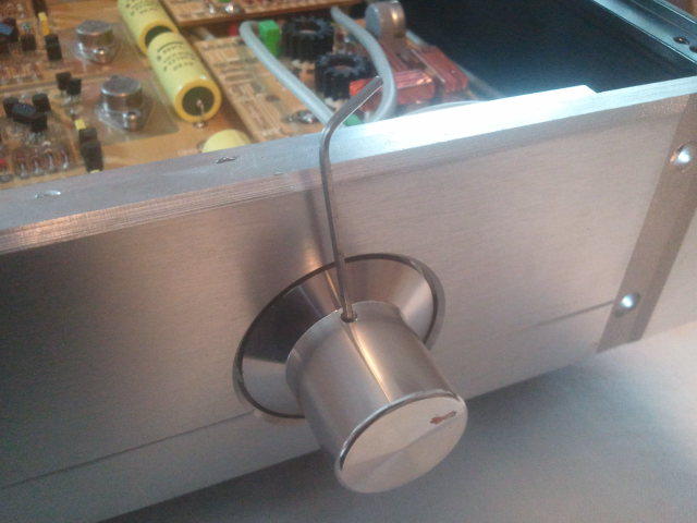

Opening Ganeda Pre Amp to change the volume.

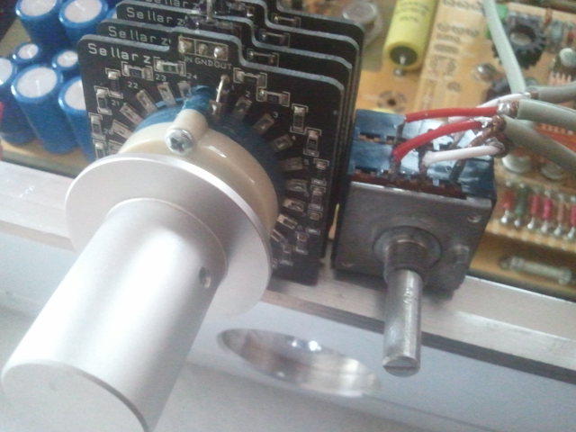

Before and after. Apls is not at all small(it is a big size) but Sellarz is too big.
25392F4153D5C47527163E
Ready to change but the attenuator is bigger than the space to place.

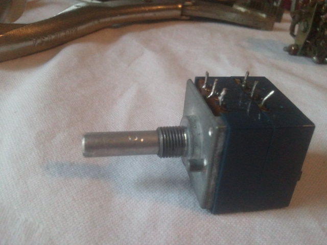

Old volume is retired.
