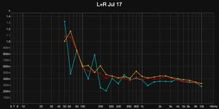

Thanks to generous help from @kratu I could finally get the acoustic measurements in my room.
Here is the RT60 graph
ChatGPT points out that I have a problem between 40-100 Hz and need to use large bass traps in the corners.
Any thoughts, opinions and suggestions?
Reducing the RT60 in the low bass may make the overall system (speaker + room + listener) sound anemic ... ?

For any passive object to interact with a specific wavelength, its size needs to be approximately one-quarter of the wavelength. This makes it challenging to treat low frequencies using any passive device to reduce RT60.
Example: The wavelength of an 80Hz sound wave in air is approximately 4.3 meters or 14.1 feet. The REW measurement indicates a problem between 60-100Hz in my room. This translates into large (ugly) corner bass traps.
But more worryingly I am not able to hear the reverberant bass or boominess. So pondering …
Gotcha. However, if the problem is between 40 and 100 hz, you will land up with bass traps that are quite large. Are there materials that will work on such large waves but are smaller in size ? I was wondering how one can make it small even if it is tuned.

I think the larger size of the wavelengths at these frequencies will dictate the density and thickness of the bass traps. If using bass traps they are going to be large and ugly.
I am reluctant to go the DSP-DIRAC route, but a equaliser that allows adjustments by hearing might be one way.
The big issue for me is I am not hearing the RT60 problem identified by the REW process.
I spent several hours today with a variety of music trying to do this.
Maybe I will just let it be and enjoy it as it is.
Sometimes what the mind does not know, the ear will not hear 😊
Yeah, RT60 can mislead. Trust your ears. The utility of RT60 is that it's mostly repeatible. People (all of us) try to improve what we can measure, right?
IMO, the wavelets are the way to try to make sense of what something might be and whether it is (or should be?) fixable or not.

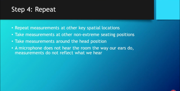

Thanks for this useful and informative tutorial.
We did not perform the first three recommendations. I was not aware of the fourth in the list.
