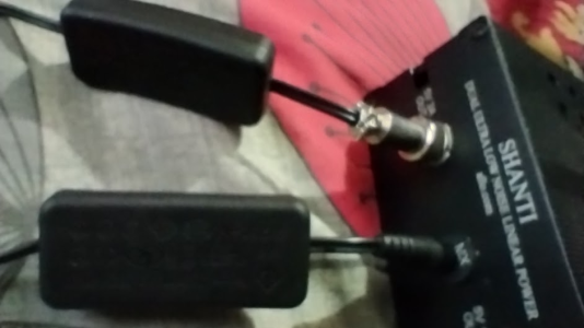

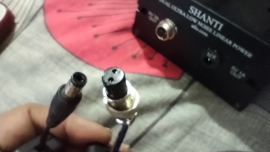

For RPI3 and below it doesn't matter nirvana or shanti. The Nirvana SMPS is one of the few well designed SMPS and gives extremely stable supply as long as power drawn doesn't exceed around 2 amps. For RPI4 and above or any device with demanding load, Shanti has more grunt and hence will easily maintain a constant voltage. The only issue with shanti is two thin cables supplying the 3A and 1A output. A thicker wire should be there to reduce the I²R loss. With a bit of diy you can put thicker cable and use aviation connector for the two outputs. You just need to drill two holes - one for the 3A output and one for the 1A output. Something like below. But even without the DIY the shanti very good for the price it sells for.
