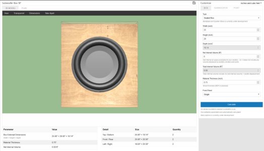

21" Sealed Sub Enclosure Plan

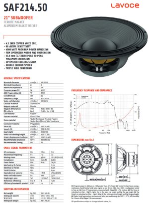

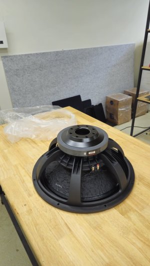

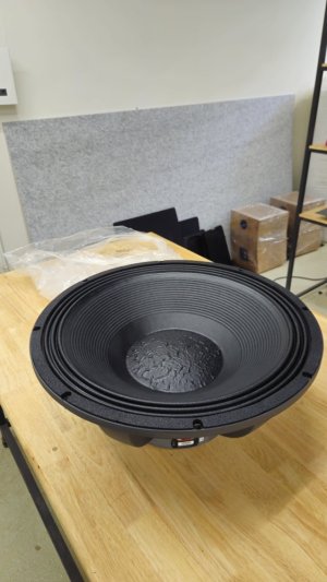

We decided on the Lavoce SAF214.50 driver and I bought it from Narain Audio who are the official distributors for Lavoce in India. I had it delivered to Albin's workshop.
Driver's specs:
Lavoce SAF214.50

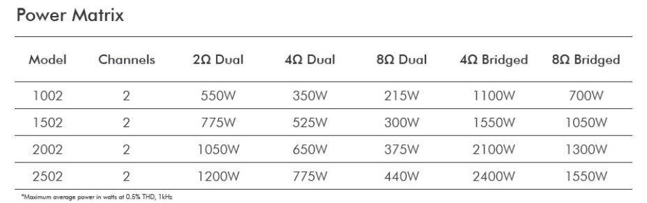

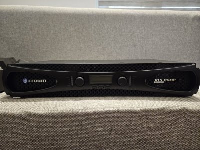

I also had to decide on a power amp and landed on the Crown XLS 2502 which can do 1550W at 8ohms Bridged. The SAF214.50 has an AES Power Rating of 2000W but amps that can drive that kind of power was out of my budget. I figured when I do upgrade in the future, I'll also feel like I got a new subwoofer :) Another reason for choosing the 2502 is because you can toggle the input sensitivity between 1.4Vrms and .775Vrms. The subwoofer pre-outs on my Denon X1800H apparently only supplies 1.2V and I read that people had to get an ART CleanBox Pro to boost the signal which would have added to the overall cost.

Bought the amp from AVL Marketing in Kerala

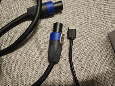

AVL also made the Neutrik SpeakOn cable for me (HDMI cable next to it)

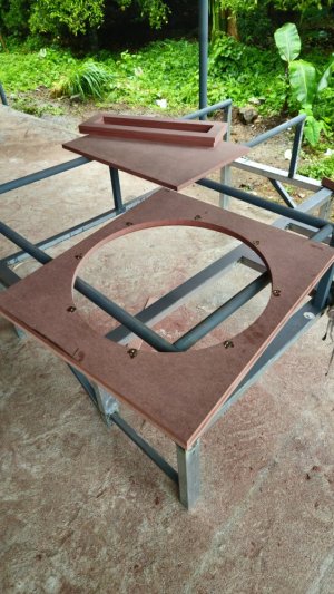

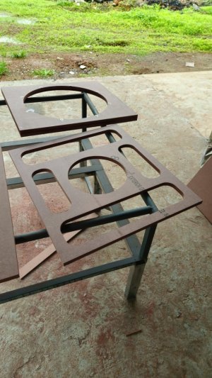

Albin cut the MDF sheets using his CNC machine:

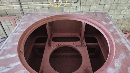

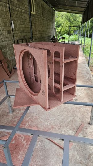

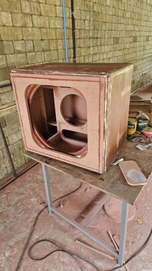

Initial Assembly with bracing
A member from the AVS Forum quickly pointed out that it would be good to add bracing between the window brace to the baffle.

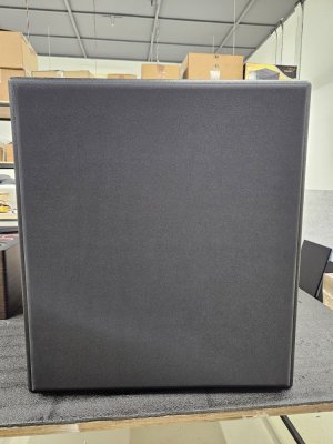

I wanted the subwoofer to also have a magnetic grill to hopefully protect it from curious people and from dust

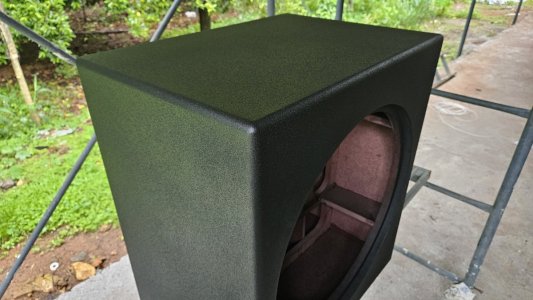

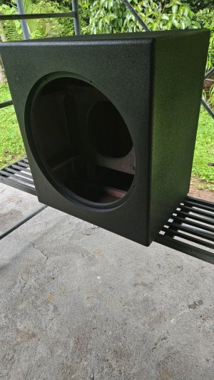

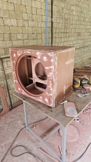

Primer applied

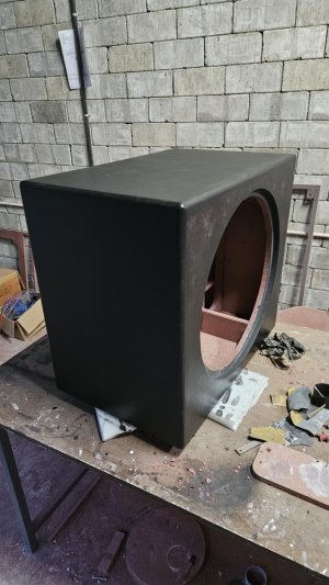

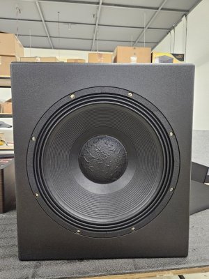

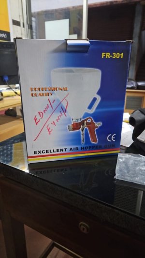

I wanted the sub to have a specific finish after watching some of the American DIY subwoofer videos. They apply Duratex which isn't easily available over here and plus it's expensive. So I opted for Granotone's Sand Finish which I think looks similar to Duratex. Albin has used texture paint in the past and applies it with a roller but I wasn't happy with the finish. So he went and got a paint spray gun for this project.

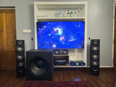

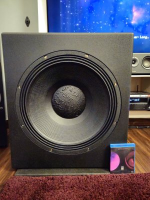

My config - 5.1.2, Hisense 65" QLED, Denon X1800H, Taga Harmony 607 5.0 package, Taga Harmony TOS 415 for Atmos, Crown XLS2502, Dune HD Homatics Box R 4k Plus

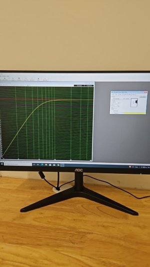

Note: I still haven't figured out the placement for the subwoofer. Kept it in the front mainly to take a picture. In all probability, it'll be kept in the rear corner to act as a near field sub. I ran the latest Audyessey One Evo calibration and I'm very happy with the performance. The bass is tight and precise :)
