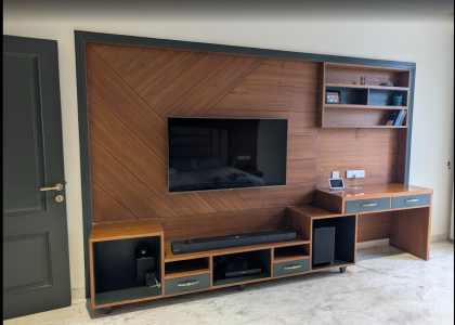

Need your help to find out a soundbar replacement.
I've been using a Sony HT-ST5000 soundbar for the past 7–8 years, but it's now become unreliable—it sometimes outputs sound, sometimes not. Sony no longer has spare parts available to repair it. As expected, the built-in speakers on my LED TV sound terrible, especially for dialogue, and I can't tolerate the poor audio quality.
While designing my TV wall (photo attached), I had originally planned for a 65-inch TV flanked by in-wall LCR speakers and possibly a small subwoofer. At the moment, I'm using a 55-inch TV, but the wall has ample space for a 65-inch upgrade with speakers on either side.
However, I recently discovered that the cavity behind the TV wall is only 2 inches deep, which may not be sufficient for typical in-wall speakers, typically 4 inches depth required
I'm not an avid movie watcher—most of my usage is YouTube and OTT content. My goal is to significantly improve sound quality, especially dialogue clarity, without spending too much. I'm open to installing an AVR and three speakers (LCR) if it fits the budget.
Room : Bedroom
Room Size: 18 x14 x 9.5 Feet
Budget: Under ₹1,00,000
Priority: Clear sound, especially dialogues
Use: YouTube, OTT content
Concern: TV wall cavity is too shallow for in-wall speakers
What are my best options to get better audio than the TV’s built-in speakers given these limitations?
Thanks.
Vivek

If that is your room, there are a number of things you can do to improve the sound with current setup.
1. Put that subwoofer on the floor. That cabinet upon which the sub is currently sitting will vibrate and will create resonances and make the bass muddy and that will affect the upper frequencies too.
2. Raise and isolate that soundbar from the cabinet using some device from iso acoustics.
Just buy a pair of appropriate ones that can raise and isolate and aim the bar to your ears.
Doing these two things will change the sound substantially.
The other option is to change the full setup.
Get a basic avr from the likes of marantz slim series and get a pair of wall mountable book shelf speakers and a sub woofer that should be placed on the floor.
- Mount the speakers by the side of the TV. Mount them onto the wall after making approproate holes through the cabinet into the concrete wall. They should be firmly mounted to the wall. Try and get front ported speakers to reduce port issues since the speakers will be relatively near to the wall as compared to a stand mounted ideal setup. There are also on-wall speakers that will just probably need 2 sturdy nails to fix. You can try those too. They will be slightly lower in performance than a pair of nice bookshelf speakers on wall mounted brackets. But the onwall ones are visually more appealing.
- Subwoofer at the corner of the room firmly on the floor with some breathing space around it and the wall.
- Get a centre channel speaker if you really need it but mount it the same way as the other 2 speakers. Firmly on the wall with sturdy brackets unless they are the onwall type.
