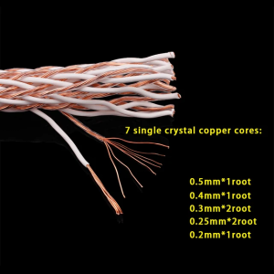

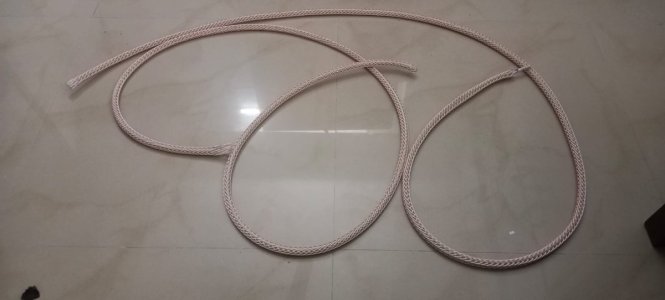

Vari-Strand from Solid Core: DIY Built
What is the Cost of this cable:
Since few members asking about the cost involved, thought of putting it across.
The cable and sleeve are 60 meter bulk import just fractioned the overall value to 6 meter, rest are all on actuals.

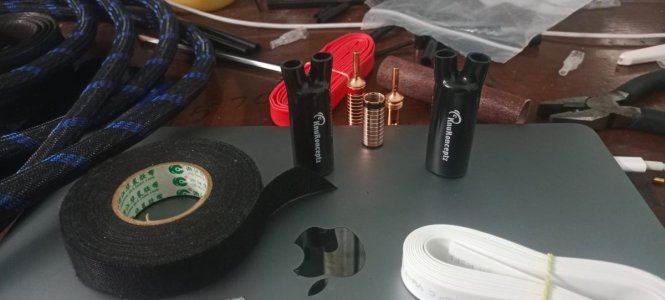

6. Knu Koncept 8 AWG boots
$6.00​
498​
249​
747​

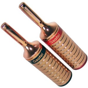

3. Yarbo Audio, Gaofei Pure Copper Spades (pk of 4)
£40.00​
4080​
2040​
6120​
4. Yarbo Audio Gaofei Pure Copper Banana Plugs (pk of 4)
£30.00​
3060​
1530​
4590​

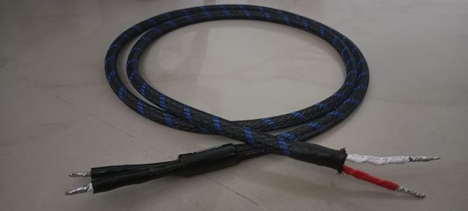

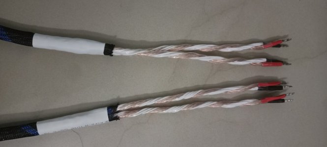

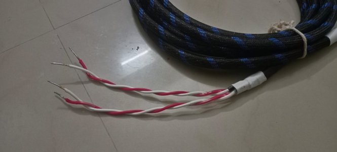

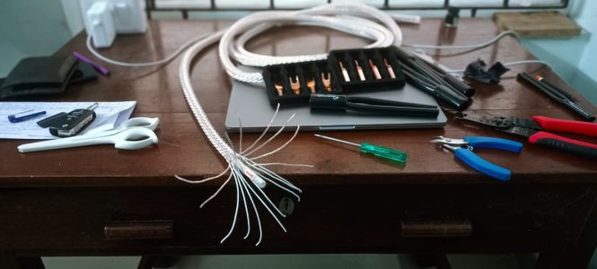

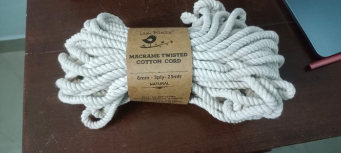

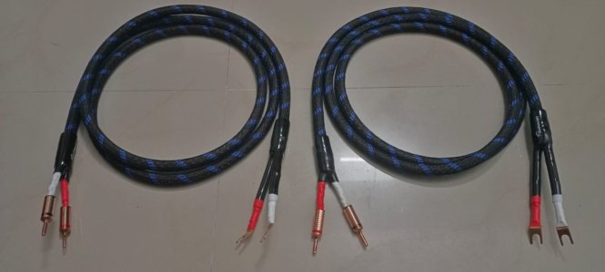

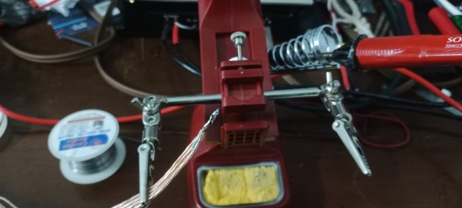

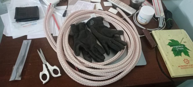

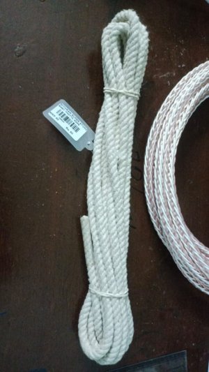

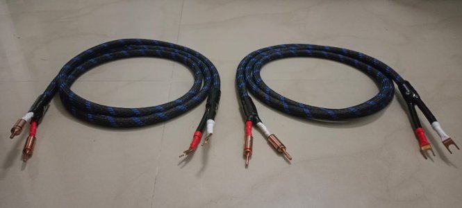

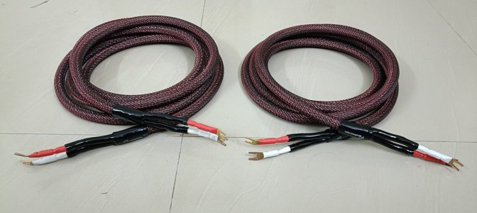

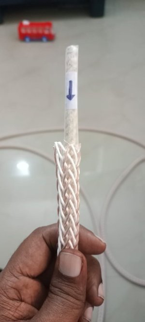

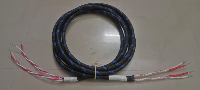

Made A pair of bi-wire cable to install in Jetta for tweeter and midrange. This time used 6 mm cotton rope to have thinner cable.

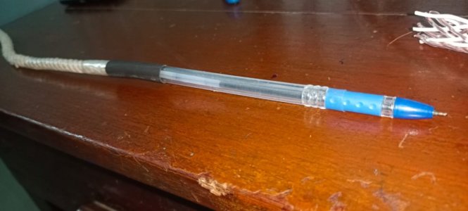

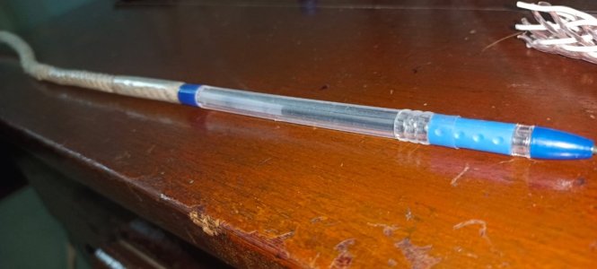

Used a hand glove to save palm while squeezing

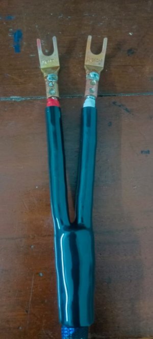

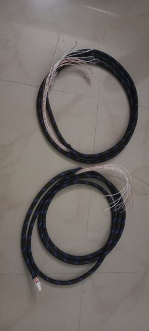

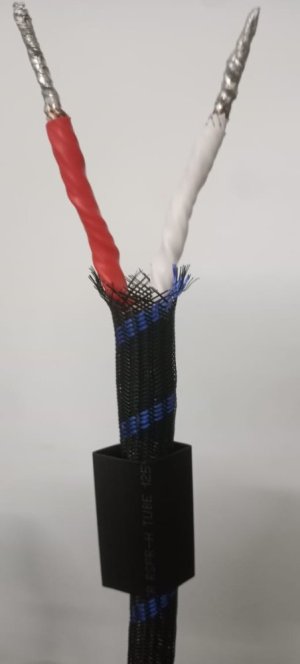

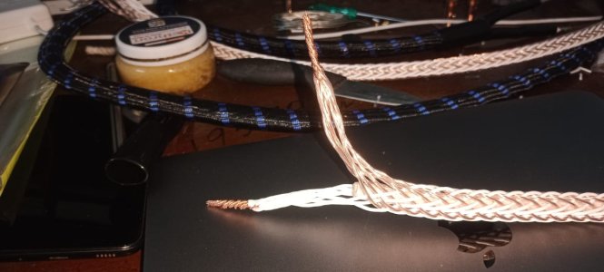

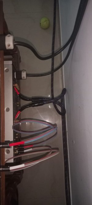

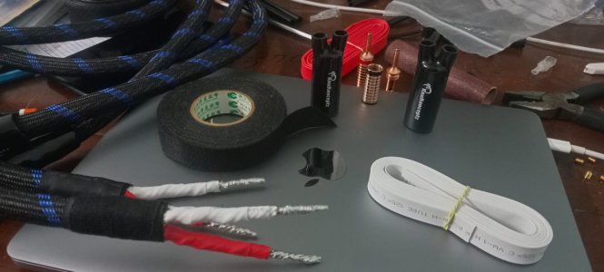

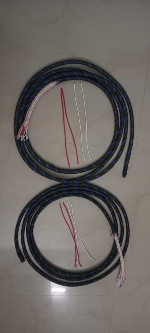

Used a Single solid core cable for speaker side hookup and amp side left it all as it is.

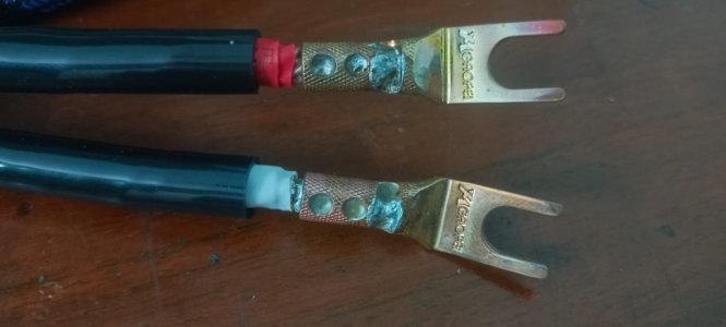

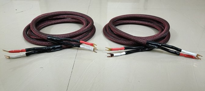

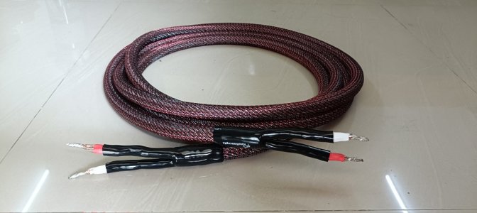

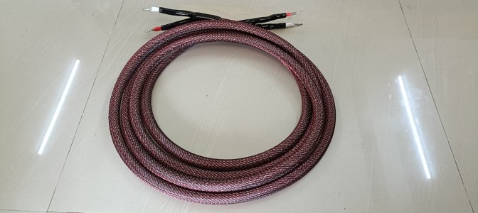

The final finish with soldered ends and with transparent heat shrink.
WhatsApp Image 2023-09-05 at 18.22.26.jpegWhatsApp Image 2023-09-05 at 18.22.26 (2).jpegWhatsApp Image 2023-09-05 at 18.22.26 (1).jpeg

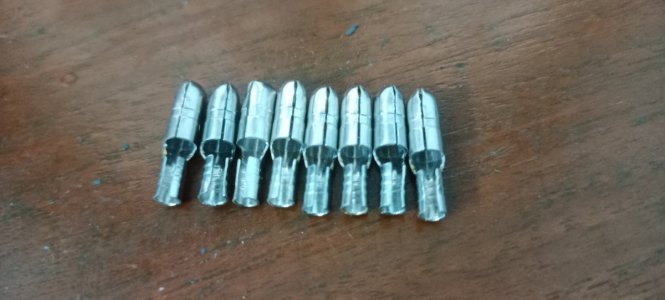

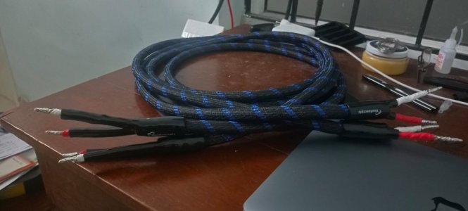

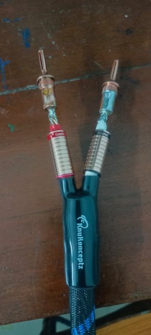

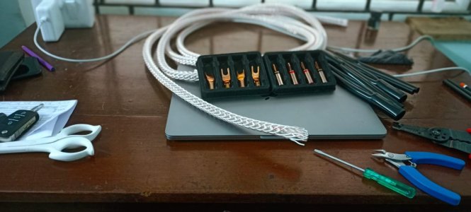

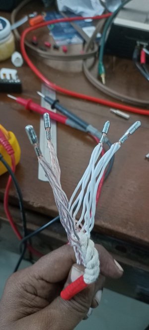

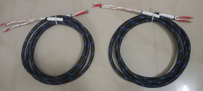

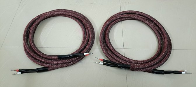

Made a pair of cable for Vento, this is going to connect McIntosh amps with tweeter and midbass.
This time used bullet plugs for hookup wire connection.

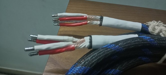

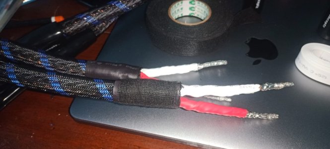

Getting the bullet plugs ready to hold the wire.

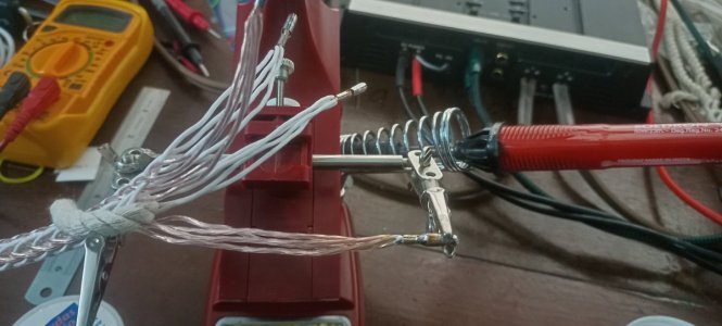

Crimping
Soldering to have better connection

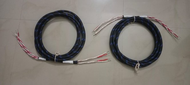

Work Finished cables

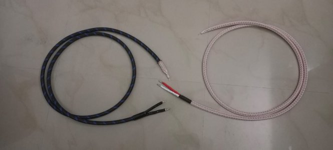

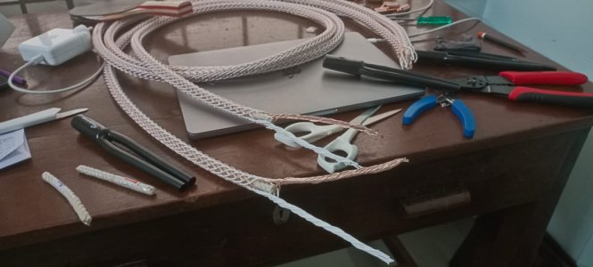

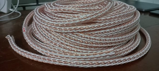

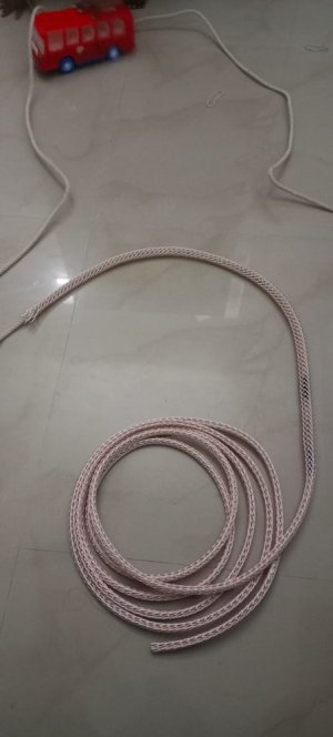

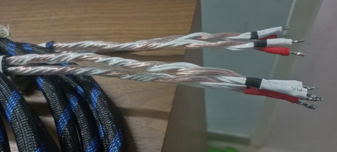

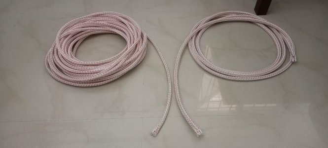

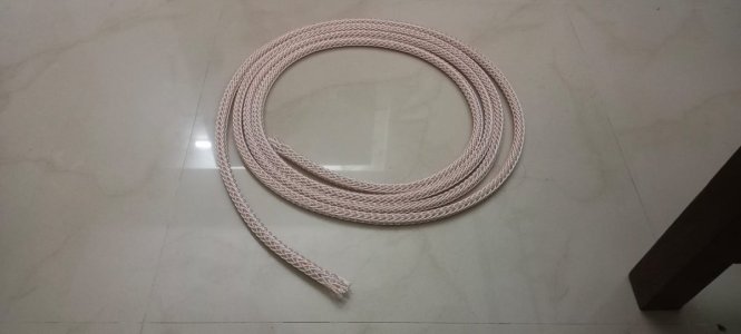

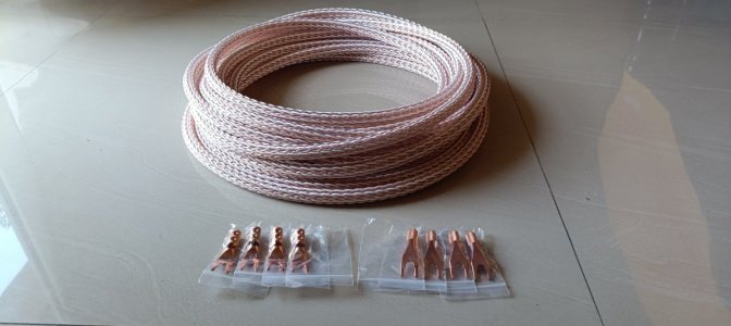

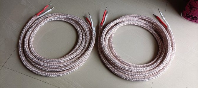

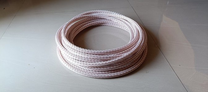

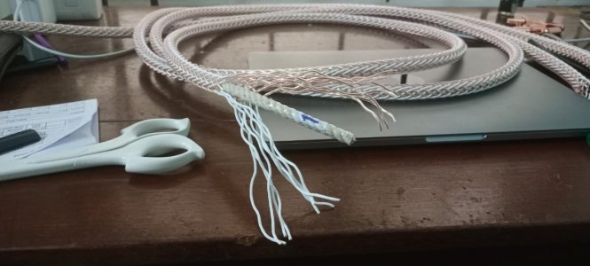

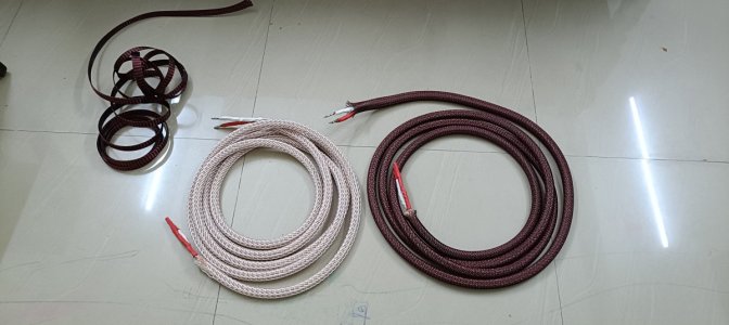

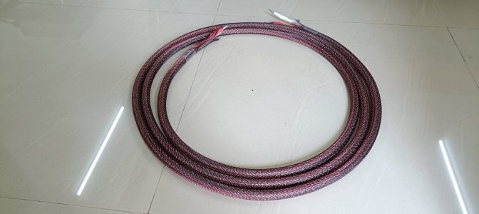

Got a chance to buy 12 TC 10 meter cable. Decided to try them with 12mm rope in it.

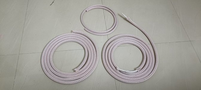

Cut a 1.5 meter for making interconnect and other Hook up wires. Bifurcated the remaining wire in to 2, which is 4.25 meter each and put 12mm cotton rope in to it.
Crimped the cables on the end and solder the tips with Mundorf silver solder as usual.

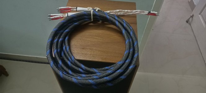

View attachment 92122View attachment 92123
Cables ! And today I realized these can look Beautiful! too.
Yep; all we need is witty hands and little time, it may appear pleasing any one.

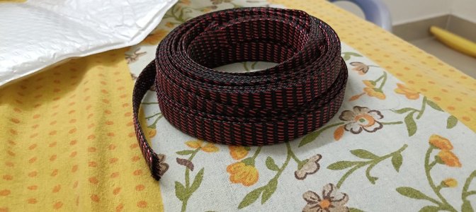

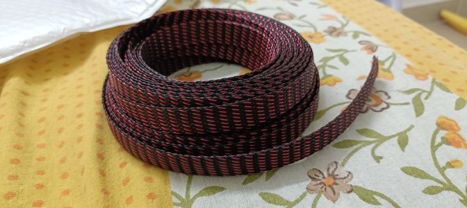

Just realised running short of sleeves. Planing to buy some.
Kindly suggest some good 15mm cable sleeve.
Will keep posted.

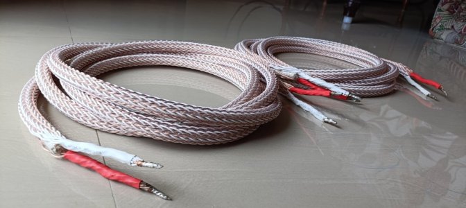

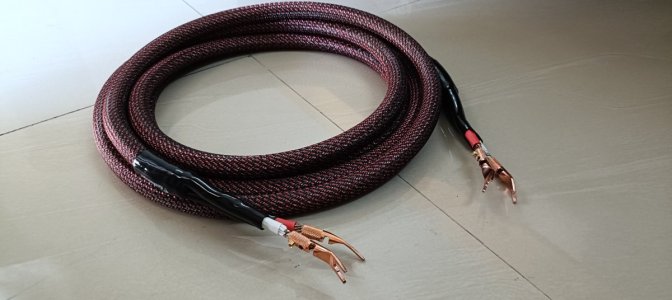

The cable terminals are soldered with Mundorf supreme silver gold solder for best conductivity and performance.
My choice of terminal is always copper spades as the binding posts on my speaker are copper.
The cable looks massive and I cannot wait to audition it.
