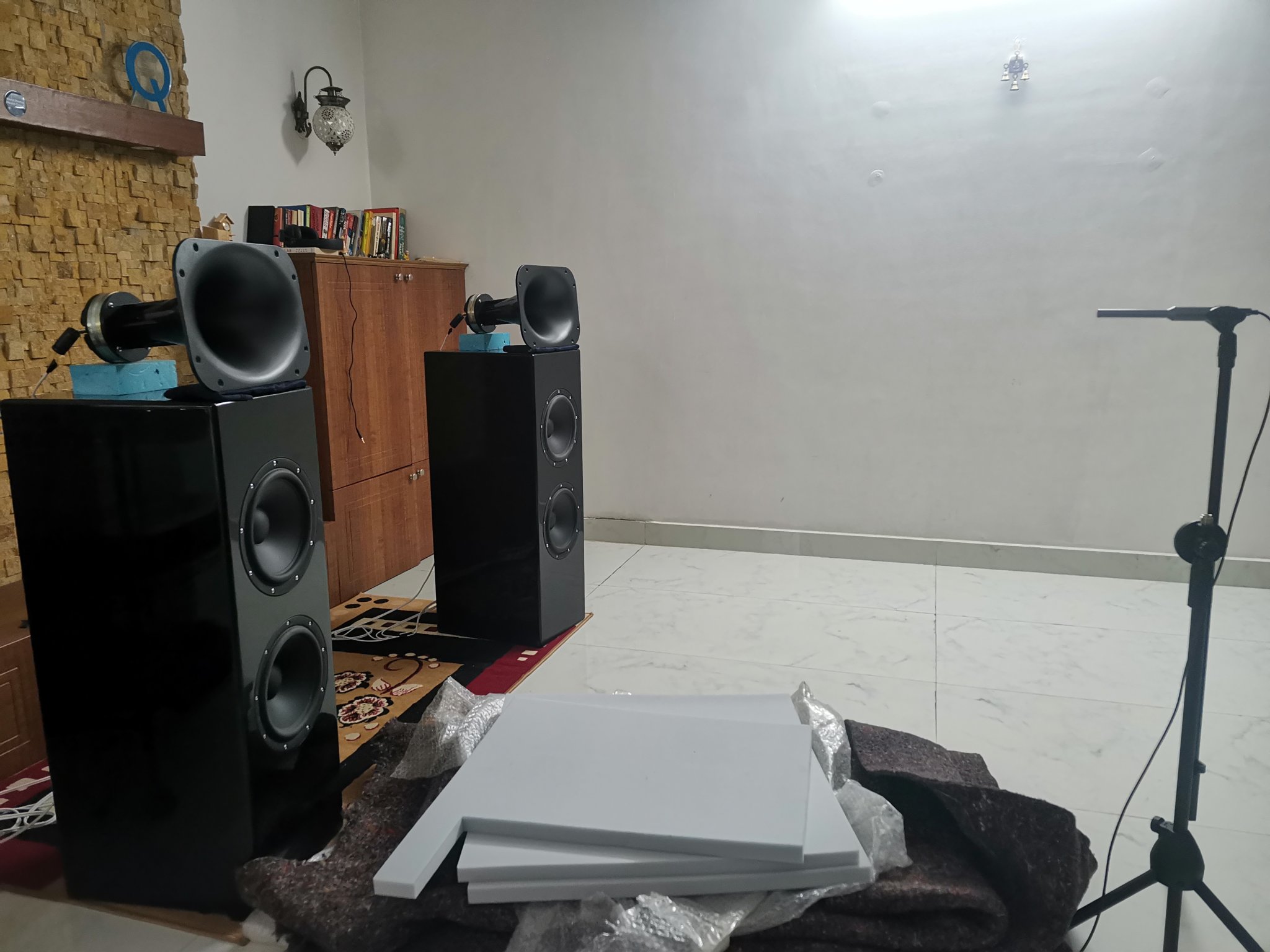

System-1: 2 way system with Satori WO24P-8 + SB audience Rosso 65CDN-T compression driver on Faital Pro LTH 142 horn
img_20220622_194538-jpg.1065807

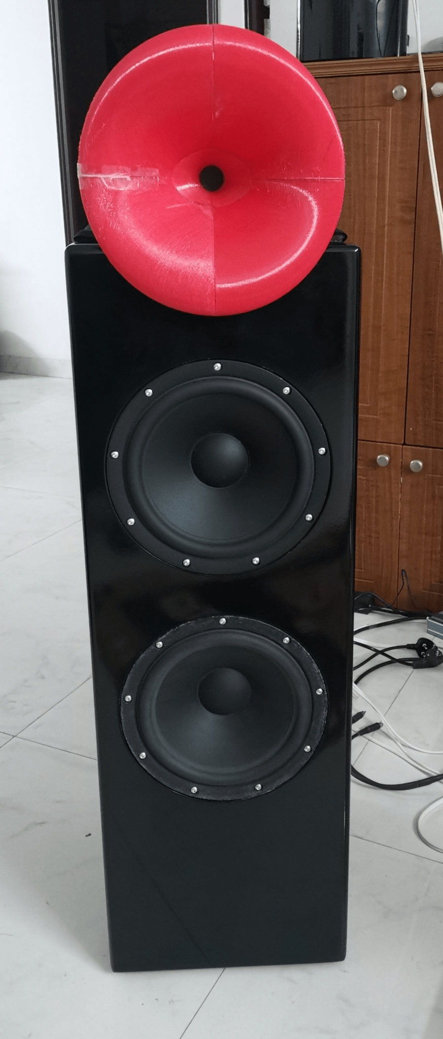

System-2: 2 way system with Satori WO24P-8 + Peerless DFM 2544R compression driver on 3D printed ST260 horn
1666845220271-png.1103273

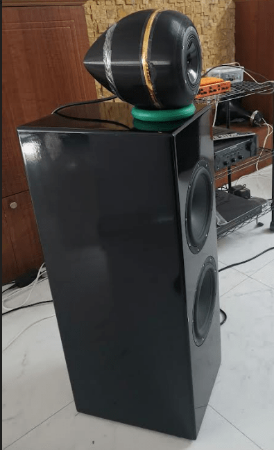

System-4: 3 way system with Satori WO24P-8 + Wavecor WF120BD03 mids + SB26CDC in elliptical waveguide
img_20221118_225719-jpg.1110876

Now, as one can see from the DIs of the different speaker configurations above, the directivity control employed varies from one to the other. So does their imaging vs soundstage dimensions tradeoffs and their interactions with the room (boundaries). Audibility-wise the acoustic resolution in different frequency bands changed due to the varying levels of directivity control. All are good and sound nice. But keeping in mind ones personal preferences, space available and listening position location, room size and type of room (completely closed/semi-open), one should pick their version of the "poison". So far what I have found out it slowly increasing directivity with balanced room acoustics (after room treatment to some extent) is the best compromise that I can live with :)
