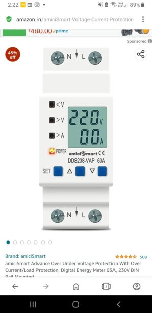

  3. Add the Voltage surge protection switches we get on amazon in MCB (Take three single phase voltage cutoff switches)

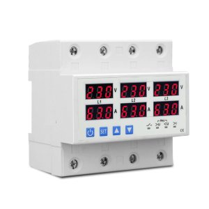

You will need 3 phase Voltage protection (under/over protection, surges) near Meter/MCB
