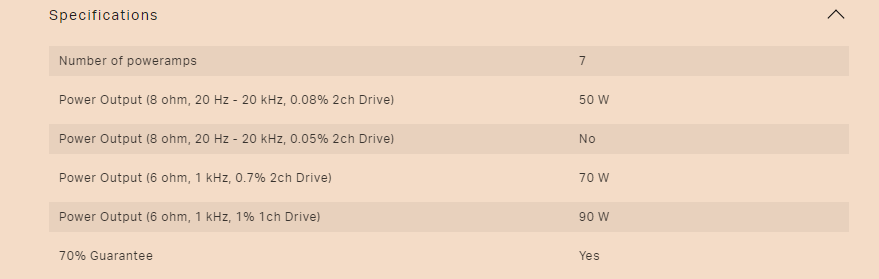

i checked out the specs and its great. i couldnt find the exact model that you mentioned, maybe its marantz 1711 that you tried to suggest? I have another question, the specs mentioned these power outputs. and i couldnt understand what they mean at all.. is 90W its maximum output? if so, how could i find the minimum output required for my above-mentioned speakers? i was only able to find the maximum output my speakers can handle..
thank you in advance !

The way to look at power is to look at the FTC rating - at 8 ohms, 2 channels driven, less than 0.1% THD. The Marantz 1711 is 50W FTC, the SR-494 is 80W FTC.
Looks like 75k is the MRP of the SR-494 you’ll definitely get a discount and be able to get it for around 60-65k
