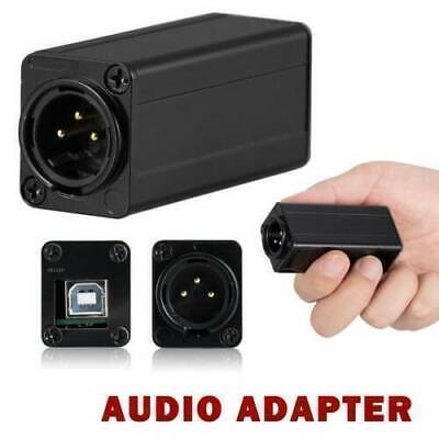

I haven’t used it but are you looking for something like this?
