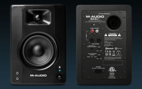

Which input method are you using currently? The speakers so not have a sub out but in case you are using RCAs for inputs you can just use an RCA splitter cable and send signal to the subwoofer.

Thaks for the response. Currently, I use 3.5 mm to 2x RCA. The speakers do not have subwoofer out. Adding an image for your convenience. This is the BT version, but the rear connectivity options are the same.M-Audio-BX4-BT-Bluetooth-Front-Back.jpg

There is another way to connect a sub when using bluetooth. You will have to split the signal being sent to the passive speaker from the main speaker. I can recommend a subwoofer for music composition purposes.
