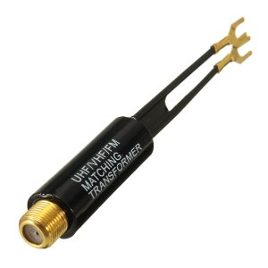

I bought a VHF / FM connector (75 ohms to 300 ohms) thru Amazon USA about a few months ago.
RG-6 cable is connected to the F-type coax connector (75 ohms) which is then connected to the aforementioned connector in 300 ohms connection.
It works fantastic!
UHF-VHF-FM-75-300-Ohm-TV-Antenna-Adapter-Matching-Transformer-Coaxial-Cable-Television-Coaxia...jpeg
