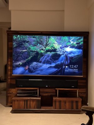

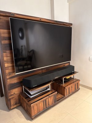

I need the right connection advise for the following items in my AV setup:
1) VU Masterpiece 65 QLED TV with Dolby Vision and Dolby Atmos
2) PS5
3) Nvidia Shield TV Pro - 2017
4) Amazon Fire Tv Stick 4k Max
5) Sennheiser Ambeo Max Soundbar
My Plan:
TV to Soundbar - HDMI cable via E ARC (Personal Preference)
PS5 directly to TV with included PS5 HDMI Cable
Shield Tv Pro to Soundbar
Amazon Fire TV 4k Max Directly to TV (Sometimes I may not want to power on my Soundbar)
In the above will I get Audio from the Fire tv and PS5 from the soundbar when I want it with Dolby Vision and Atmos encoded since the TV has E ARC support ?
HDMI Cable Selection: Whats a good option to buy High Speed reliable and reasonabl HDMI Cable from Amazon. I checked one from Spigen, Bluerigger etc which fits my budget. Dont want to overspend on it.
