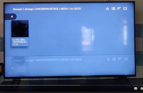

My Sony X90J55 started to show the double image with horizontal lines flickering at the lower third part of the entire TV. Like in the image attached below.
You can also check the full video to get the clear picture of what is happening in the drive link below:
Link: https://drive.google.com/file/d/17Nb2m_LjE93RRFmTxWiPWWUcZmhDVn_8/view?usp=sharing

Can it be a software issue? Did you try resetting the tv?
Yes, I tried the soft reset and the full reset which did not prove to be fruitful. It is not a software issue and many technicians said the same. I did try the tape method of blocking a few pins on the cable with the help of a local technician.
This solving the horizontal bands issue but creates a new one. So now the colors on the right side of the whole panel look a bit dull and the RED color is very desaturated.
If anything more that can be done to resolve the desaturation, any help would be much appreciated. Thanks.
