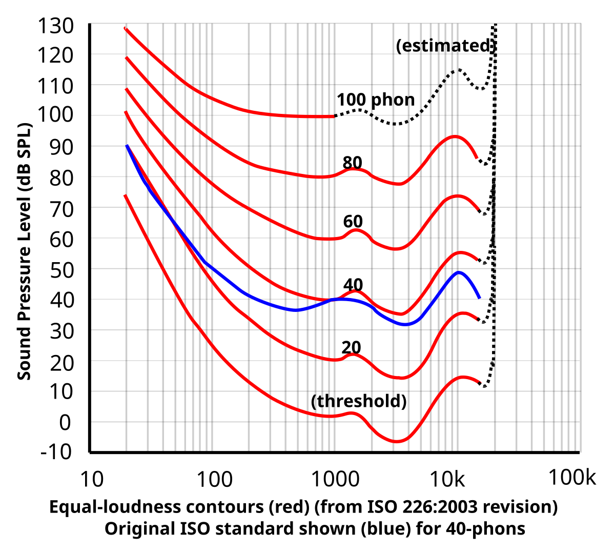

HI have a question for you. I have been playing with the Loudness feature of the RME ADI 2 DAC FS, it changes the sound signature drastically. What is the benefit of that?
At low volumes, as per our human hearings nature, our sensitivity is only good at midrange, meaning we need a boost on highs and lows to make it sound even. It’s meant for low loudness listening.
So good only listening at low volumes? Is that what you are saying?
Once you push the volume up, our ears are more sensitive to highs and lows so the effect will start negatively affecting the sound. It means at higher volume levels we then will hear a V Shaped signature.
For more details just read this page :
