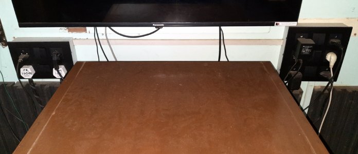

The return of that dreadful annoying 50Hz hum. This time when switching on pre / power amps and Allo Boss 2. I had recently installed new GM switch box modules. The amps were connected to the left box while the Boss was connected to the right box. While both switch boxes are on the same line, I guessed that this hum might be caused by a classic ground loop. So I experimented by connecting the Boss 2 to the left box i.e. same box along with the amps and lo and behold... the hum has gone away and hopefully for good ! I am relieved and back to music land. 😀😇
If you don't have a single point grounding, ground loops can cause this hum. No need of music signal. A single earth should return to the main socket of your house wiring. All my gear is on one earth bus of a power strip.
