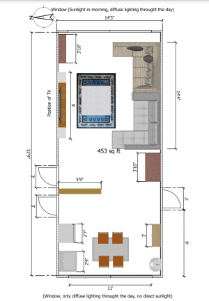

I am currently in the market for a 65 inch TV for my renovated living room (still a work in progress). I currently have an archaic 47 inch LG 47LD460 LCD TV which is not wall mounted (10+ years and still going strong). However, I am in the market for a wall mounted unit that will look well with the overall decor of my room. I have attached a dummy room plan that I made using a software online for a rough idea about the lighting condition and the space that we have to play with.
My typical viewing mix and typical viewing usage:
Daily around 4 hrs SD Local News Channels (Via Jio TV/Jio Fiber), 1.5 hrs OTT (HD/FullHD/4k) wherever applicable via both onboard OTT of TV/pen drives, 30 mins casting/laptop usage/gaming (but this 30 mins can be ignored for now and gaming is not a priority at all)
My requirements:
1. I would prefer a QLED panel without any reflections (or with as less reflections as possible). Picture Quality >>> Sound Quality for me as I might invest in a sound bar later on. For my audiophile needs, I already have a HT in a different room, so sound quality is not a primary concern here.
2. My budget is around 1.2-1.3 Lakhs. I would prefer among the top 3 brands but am open to the other players in the market as well.
3. Not a fan of OLED screens particularly because of the reflections. Room will not be dimly lit in any circumstances. I have 2 OLED laptops at home and the reflective screens make them very unpleasant in any sort of sane lighting conditions. Also, with my typical usage scenario, burn in is a serious concern as well.
4. Viewing distance will be around 9 feet to 12 feet.

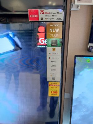

Not sure about the model LG with the picture frame - it was in the nano Cell range and a 75", it had a Gold engraved photo frame. BTW was surprised to see a SONY & LG offering 75" sets around 1.20 or even less! The picture quality was not bad at all, infact my friend is very tempted to change over to a 75.... Both Croma & Relaince had them. Like I said, I now do not find the need to spend a good 30/40K more for the Sony X90- the quality difference just does not justify that, unless, of course you can spare the money.
Am observation from this year is that, 3 big retail chains are NOT pushing the Samsungs at all.
Sony 75" for 1.2L? Hard to believe. 1.5 to 1.6 lakhs yes. But 1.2? Where? which city?
Pune Croma A80 I think it was ...there was an LG too at 1.19....Reliance had an LG same range. think they mentioned 7.5 off...will check as I plan to make a trip again plus to check the Sammy Neo Qled..will also ask my friend if he remembers as I was not paying too much attention at the 75....
