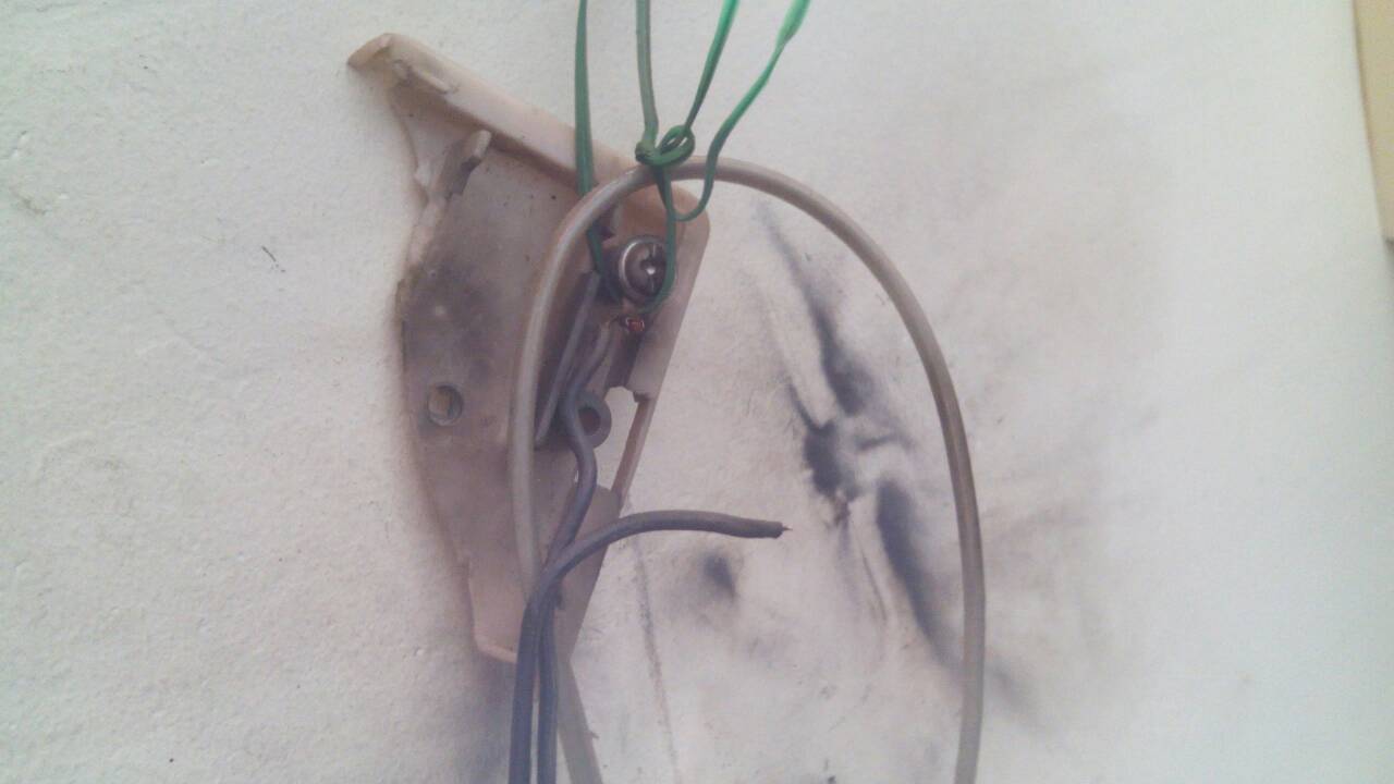

Oct'15 - I wasn't at home that day, it was raining heavily with lightning... Even before my wife could turn off the plug point that houses the TV, AVR and other hi-fi stuff, in a blink of a moment, a lightning struck on my roof top (Live in a flat 2nd floor) completely shutting down all my equipments... There were some cracks on the roof toop walls.. Not too deep, but yes there was a crack.. (Grounding wasn't done..)
The lightning struck on a telephone cable that was tied to wooden pole at 6 - 7 feet high.. The pole was approx 10 - 11 feet high used to dry clothes.. about 3 - 4 feet of wooden pole went into pieces on the rooftop... and the telephone cable caught fire.. My wife wasn't aware that the telephone cable caught fire... The broadband splitter box burst into pieces.. Since the telephone cable caught fire and went unnoticed for a long time, the heat got transferred thru the copper cables to the modem+ router and everything that was connected to it was affected..
Don't know if grounding would have saved me such a lightning attack, but AVR refused to start...It went dead.. TV was switching on, but there was no output.. PC also went dead.. Modem went dead.. Lost my STB too :sad:
Never seen anything like this happen..I was devasted :sad: I had to look at reinstating components one by one.. Don't know how much would that drain me..
