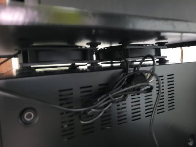

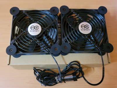

What I am writing is not something new & some FM's may already be having different models of the company. These dual fans are usb powered & can be plugged in behind an AVR/Amp supporting usb port or directly in a power strip which supports usb ports which I have done. They are ideal for gear which tend to get too hot like avr's, class A or hybrid amps, gaming consoles, etc. They can be place horizontally(if the top AVR/Amp cover is flat) or vertically & can be daisy chained upto 4 fans through a given usb port. The fans have a speed controller with 3 speeds(O,L,M,H). Even at high speed I could not hear any sound, they are that silent or maybe my hearing is not perfect. They have soft padding(removable) on the legs on both sides so that they don't scratch the gear & avoid vibrations. You do get powered model S7-P with a plug. It comes well packaged with a small manual.

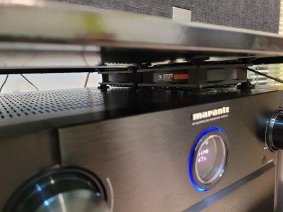

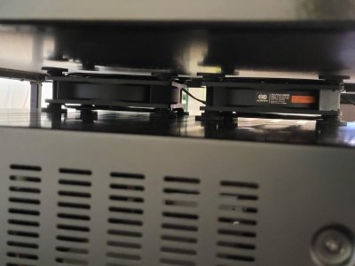

In my case the Marantz avr gets too hot to touch when used without an airconditioner especially for movies. I tried these fans placed in a horizontal position on the avr over the hottest areas without keeping the AC on. Watched a movie for approx 2 hours in Mumbai's hot n humid weather during april with myself perspiring a bit. The fans were kept on high speed & later felt the top cover of the avr . It was just about faintly warm which otherwise without the fans would have been very hot to feel. The good thing about them is that with hardly any space in the rack above for heat dispersion (images attached), the fans did a superb job in cooling. With the speed controller setting at medium, the top cover gets just a bit warm & not hot.

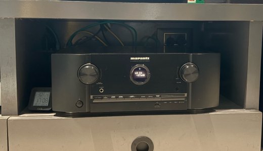

@Nitin K I have 3 inches to all three sides - left , right and top. If i place rhe fans to the top, won’t it cause a hot air vortex in the TV unit?
I just checked that with ambient temperatures at 29, the top of AVR is 49 and L and R are at 38-40 Celsius.

In my rack, I have left, right, front and behind space open. With barely any space on top just enough to fit the fans , there was absolutely no issues in cooling.

So you think it will work perfectly fine for me as well ?
Since you have 3 inches above your avr, it should work in your case too. I have less than 2 inches space on top(approx 4.5 cms), yet managed to fit the fans & keep the avr cool.
On a different note, I had placed 1 fan vertically on the side of the heat sink but there was no point in that exercise since the avr height is 7 inches and the fan was barely reaching the vents. Hence placed both the fans on top over the hottest areas.
If your avr height is less, then placing it vertically on the side should do the job, but I see no reason for this since you have enough space on top to keep the fans.
From pictures you have shared, I doubt if these fans can do anything at all to get heat away from the system. You risk trapping heat within the area. There is no space or clearance to exhaust the hot air. It will benefit to place them under the unit.
Heat rises up. Naturally. What you've done is restrict that movement, cause the fans no longer have space to exhaust air.
What will benefit more is to relocate the AVR with no restriction on top or atleast more than what is there currently. The unit is running hot cause there is nowhere for the heat to go.

If you are referring to my case, then they do a fantastic job. I have experienced a vast difference in cooling.
Besides they will not fit under the avr.

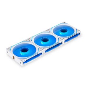

These fans seem similar to the ones used in the PC cabinets so it you want to have them for cheaper than amazon then just look up any fan manufacturer e.g. Artic, BeQuiet, Fractal Design, LianLi, Noctua, etc and then just research the importer for these products and have it shipped them directly to you.
Also, now PC cabinet fans come in daisy chain like shown in the image so you will be occupying only one USB port on the AVR if you decide to use this product.
This should also be a good alternative.
