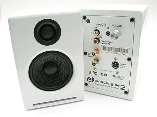

I produce music as a hobby and have a home studio with studio monitors and also have an onkyo receiver with magnat speakers set up.
I now want some compact portable hifi speaker to take with me with my laptop. For coming a little closer to mixing, I have my audio interface and german maestro headphones, which are really good. Doing final mixing and mastering is impossible though, due to lacking spatiallity on the headphones. The speaker set I want to bring with is not for mixing or mastering either. Small speakers won't give me that option anyway, so I want the best sounding most portable setup. With emphasis on portability, high quality sound and having a subwoofer with in case I really need a good bass with me as well.
So far, with lot's of reading reviews on the net, I came down to this set:
Audioengine a2

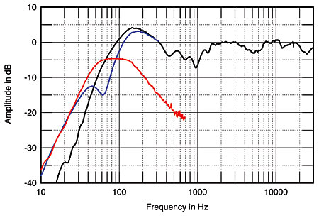

taken from Audioengine 2 powered loudspeaker Measurements | Stereophile.com

Now, my question is, do the subwoofer and speakers work together?
Can I hook my laptop through my audio interface to the subwoofer RCA connectors and the hook the RCA connectors of the subwoofer to the Audioengine a2?

Assume the way your setup is:
It needs to take signal from your computer to the sub - then pre out to A2.
So then you have the audioengines playing the whole spectrum including the bass, and then the subwoofer is just playing the low frequencies only - Have the sub's low frequency cut-off at about 68hz or so... since the A2's play down to 65hz.
If anything, having the A2's go as low as it possibly can means you are maximizing the usage of these fine speakers. A little bit of "blending" - meaning the A2's and the sub playing the same frequencies: about 5-8hz of overlap is OK...
Say for example you buy a sub and the phase of the speaker in the box is 40 degrees. when you adjust the variable phase knob.. at zero, the results are 40 degrees. And then you start adjusting the phase towards 180, but you have to constantly add the original 40 degrees.
variable phase knobs are used in situations described above.
you are supposed to adjust the knob until you get the most details out of the subwoofer at the listening position.
