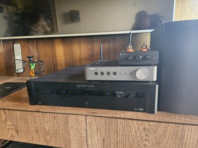

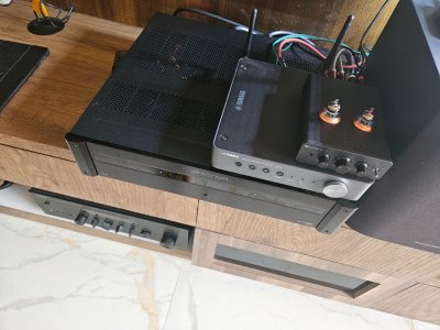

Hi! I decided to go ahead with the Emotiva BasX A2 amplifier, pairing it with the Yamaha WXC-50 as a preamp. This setup - Emotiva BasX A2 + Yamaha WXC-50 + Bowers & Wilkins ASW608 Subwoofer + Emotiva T1+ Tower Speaker has brought impressive dynamics and room-filling sound.
However, the higher frequencies still weren’t as refined as I prefer, and the overall warmth was also not so good. So, I decided to try out the Fosi Audio P3 preamp, and wow… it has made the sound so much clean, dynamic, and no distortion, So good that I never expected that this small and cheap Fosi Audio P3 can make so much of difference.
ok, So after above setup, everything was good except base, it was not as deep as I wanted from Bowers and Wilkins subwoofer. So I decided to use Yamaha receiver again and I was fideling with Yamaha's musiccast app which also controls WXC-50's settings. There I found setting Compressed Audio, which was selected by-default. It actually compress wifi audio signal. So turned it off and done. It made so much difference and highs were clean and base was deep.
