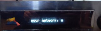

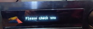

Dear FMs,
I am making a dedicated post about an issue which I faced recently about my AVR X2500H. I had posted about this same issue in the dedicated denon owners thread. (Some fellow members responded in kind)
The issue:
I don't know somehow I received an OTA on 11 December which did not complete on my device...either due to network failure/server failure (I am not sure). But I was confident it was not due to any power failure or me unplugging the device. ( My system is supplied by my UPS system which is 24x7 with big battery back up. It's a 4kw system of backup with battery bank).
My device then went into an UPDATE ERROR LOOP. Initially I was not worried as I thought the update process will restart and complete. So disconnected power, reconnected the wired broadband (bharat fibre 100mbps). And restarted
I was surprised that the issue remains. On my device display it was shown update error. (The images are attached). I did the power down power up for 3 times after which I was convinced something serious was happening. And I became a little worried.
(In 2018 I had used the USB update route. I had downloaded the firmware from firmware.denon.eu using my device serial number. So imagine my surprise anxiety when I came to find our that Sound United had stopped this service and now everything is OTA. I hunted all my HDDs, pendrives, NAS, old labtops... frantically...but alas that file was not found. I had an inkling of doubt that this usb update route could be my last resort....which later on prove to be true, as you will know from my latter part of the story)
The arduous journey of solutions and Indian customer support:
Well then started the various google searches, the re-reading of manuals. And also came across the denon website about a problem with July update error for which one has to do a factory firmware restore. Long story short: nothing worked. All I got from display was upadate error, connect to network, plug out and plug in power again.
Next I emailed denon customer support. I had registered my device, as I said in 2018.....so I logged in my account and raised an issue. I got an automated reply stating all the steps which I had done. So I continued updating them that my issue is not resolved.
In the meantime, I posted in this forum's denon owners thread...hoping if any one could throw light on how to download an USB update firmware. I got some helpful comments.
I, then , started emailing the www.preetiglobal.com and www.profx.com guys. From this forum and from the denon main webpage I came to find out that these guys are responsible for denon in India. Also my original package of the device has a label showing that Preeti Traders were the importer.(mine was a Vietnam made).
Preeti global responded fast and told me to connect the service dept. I was given a phone number. I called up and contacted one Mr Kunal. Through their engineer they diagnosed my problem as "your mainboard is gone. That module needs to be replaced". (They derived these from the images I shared.......inspite of me insisting that it could be just a software problem of incomplete firmware write.) I somehow tried to gently argue that if they could provide me a firmware file I can try the USB update route and if that fails then I will follow their advice of replacing the modules. They flatly denied stating denon has stopped that service and everything is now OTA. I was kept wondering what kind of customer service we Indians are getting. The funny part was Mr Kunal happens to be related with a parashelectronics, Lamington road.(I was left with little confusion why this was so)
I reached out to Profx, Mumbai. And a thread in this forum spoke highly of a Mr Negi of Delhi ProFx. So mailed both the main ProFx and also to Mr Negi in Delhi ProFx ( I thought if at all there comes an issue of courier delhi will be better for me).
The Mumbai ProFx connected me to their Bangalore counterpart and through watsapp I was connected to the Bangalore service dept. The engineer also had a similar diagnosis like the preetiglobal guys. However he said it would be better if I courier the device to them so that they can diagnose the issue. I gently ask for the USB FIRMWARE again...but alas the same response.
Mr Negi of Delhi ProFx responded to me promptly saying that the mainboard and network modules need to be replaced. The cost will come around Rs28000 (twenty eight thousand).
Shortly I also received another email from Mr Kunal stating almost similar things - that I need to replace my mainboard and network modules. Cost again Rs28000.
Seeing both the emails I was little wonderstruck. I mean HOW CAN I CONVINCE MYSELF WITH A RATIONALE THAT MY SOFTWARE ISSUE HAS A HARDWARE SOLUTION WHICH COST 30% OF THE ORIGINAL COST OF THE DEVICE? You can imagine the many varieties of expletives running in my brain at this time. All because of an OTA which maybe denons server fucked up...which almost bricked my device .....and our local guys are giving me no intelligent option other than a commercially profitable option to them.(and they call this customer support. The irony is even lost to me...)
Fortunately for me, I happened to get an email response yet again from Sound United. An engineer gave me a lucid provisional diagnosis ( I had mentioned the "error code of 2A02 & 2B02"). He correctly diagnosed that there is an incomplete or error in the write of the firmware. He suggested that he can send me a download link for the USB FIRMWARE which I can choose as the last resort (the USB update route) failing which I have to contact the Indian service guys. (I want to remind you guys that in my email to Sound United, I had not indicated any contact with the local service centres). He just needed me to send a rear panel photo showing the device serial number.
Now as I mentioned earlier, I was familiar with the USB update route. So I was very happy with this news. So yes, I responded fast with a rear panel photo.
And today I got the firmware download link and instructions. The rest is history.
PS. My denon x2500h is now updated to the latest firmware.
Take home mesage to FM who are owners of denon AVR - rely more on the firangi guys and engineers. Read a lot. Read the manual. Do google searches. I was saved from spending Rs 28k due to the sloppy way of customer support in India.
Think carefully whether you want the update feature. Nowadays Denon have included the update methods from Heos app, Denon AVR remote app.
Disclaimer: I am not belittling the service of the Indian counterparts of Denon. But rather reflecting a little want of improvement from their current offhand stand. I still can feel the way the so called Indian engineer talked.
