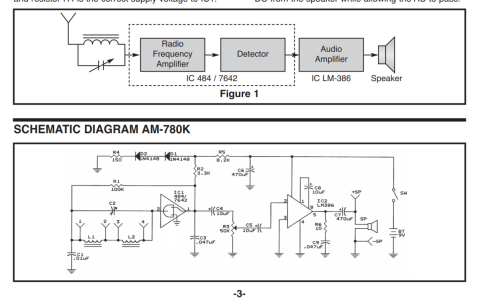

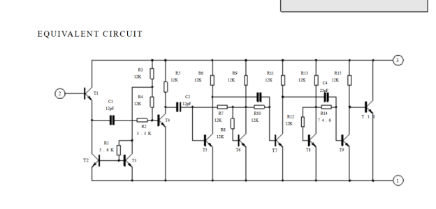

Now back to the hobby, got a TRF kit from Elenco. AM-780. It is based on a IC 7642/ 484 with a RF amp and detector in it. The data sheet shows an equivalent circuit with 10 transistors!!
The kit is easy to assemble - just took just about 2 hrs to complete.
Though there are no Oscillator coils / trimmers and the instruction does not tell to do so, a little alignment of the antenna coil is required to get the dial read close to another calibrated radio. Lots of overload from some local stations. But fun to hear it pull distant stations with the locals in the background. Some stations (may be Iran) are very clear indeed. Could pull in AIR Rajkot here in Abu Dhabi.
I did put out of my window a length of wire and connected it to the input of the IC and it made the reception even more strong. An earth connection to window frame made the bleed in stations a bit more quiet.
Maybe there is some way to make it more selective?

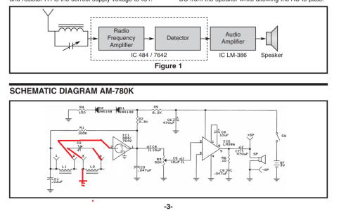

I am looking to use L1 coil of the ferrite antenna coil to transfer the signal from the tank circuit formed by the VC parallel L2 coil to the IC. Would it reduce the interference from local blowtorches and improve reception?
so View attachment 93429
I did the mods and tried it.
The overload from the torches here reduced. The dial went off by about 100kHz though. 810kHz AIR Rajkot was at around 900kHz. The higher end of the dial reduced to like 1400kHz. Even with the full coil it was barely at 1500kHz.
Need to get a LC meter and make a coil to keep it to full MW band.
