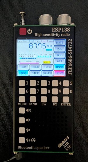

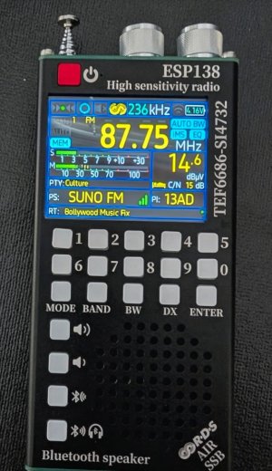

Today, I got a new radio which I accidentally found while browsing. It has both TEF6686 chip which I am interested in and Si4732 one of the renowned chip for AM / SSB bands. You can switch between the chips to listen to the bands you are interested in. FM, AM is available with both the chips.
I got it from AliExpress.
First impressions
1. Has lot of features, much more than Qodosen DX286
2. It doesn't have a 3.5mm audio out port but has Bluetooth. Sounds good when connected to Bluetooth speakers.
3. Catches stations easily. Haven't tried distant stations yet and need to check them once I get am back in India.
4. Sound quality is decent with the built in speakers. Less bass, Qodosen and Tecsun radios have better inbuilt speakers.
5. Looks more like made by a hobbyist and not mass produced.
6. Wish the antenna port is on the side or top. It's on the bottom and once you connect external antenna, you can't keep it vertically
7. TEF6686 FW is upgradable and the github link is provided in the instructions sheet.
8. Sound quality is slightly better with Si4732 chip than TEF6686 is what I felt. Need to listen a few more stations to confirm this.
9. Instructions came in English, which is a good thing. Also it's printed on A4 sheet and printed in normal fonts. You don't need a eye glass to read the instructions. Lol.
