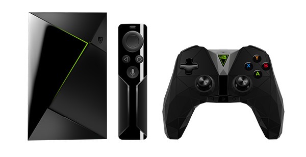

They will all play at 48K sampling rate only. I have ATV & I don't like it. I think the best device would be nvidia shield. It will be much cheaper than apple tv and not have a restrictive ecosystem. See this comparision. But I have no first hand experience because I have not heard apple music on it. I did ask on the forum for experience with apple music on shield, but no member have replied and it seems no one is using apple music on shield. So if you personally know anyone owning shield, ask them.
Based on further 'research' and the answers here, I have realised that the best solution will be to continue with my current set up for local files , and use a seperate device for streaming services. Nvidia sheild is the obvious answer and I will try to get one from the US once someone is coming across.

I saw below on the asr forum today, can any Nvidia owner confirm if it is true? This particular post also shows that it is working fine for apple music too at hires with screenshots https://audiosciencereview.com/foru...vidia-shield-on-android-11.29889/post-1094592
I have the 2017 version. Today I received the Android 11 update. In the device controls under Advanced Sound options now the Shield allows to pass all the audio untouched over HDMI. Checked on my Onkyo TX-8270 receiver and it's effectively passing all audio on its native frequency: I have sideloaded Apple Music, Amazon Music, Qobuz, Roon, Idagio and USB Audio Player Pro and it changes to the original: 16/44.1, 24/48, 24/88.2, 24/96, 24/176.4, 24/192
I think this puts the Nvidia Shield as a serious and versatile streamer option
