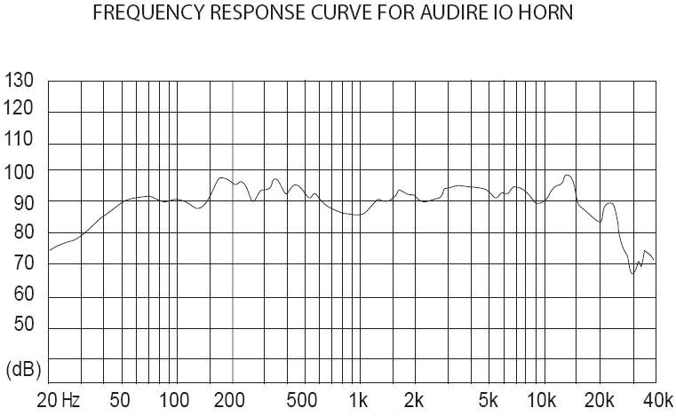

Murali had raised some points about speaker measurements and other matters. Over the last few weeks, I have worked with Audire to see how we can answers these points.
1. First here are the specs for the IO speakers:
Driver Units : 4" full range
Frequency Response: 77hz-23khz. Please verify with the frequency plot enclosed. Audire claims they generally provide conservative ratings for the same, actual bass response goes far lower than their quoted response.
Sensitivity: 93db/W/m
Nominal Impedance: 8 ohms
Power Handling: 24 W
2. I am enclosing a measurement of the IO done in an Anechoic chamber showing the frequency response curve.
3. Here is the answer to some of the points Murali raised.
These are the words of Sharath of Audire, and I have only edited it briefly for language.

We are also sending, herewith, to our good friend Venkatcr, a frequency response graph for the IO horn system that he had listened to on his visit here. So there shouldnt be any problem in cross referring to that.
All tests, plots and measurements of this kind are done in an anechoic chamber. The relevance of such data in real life circumstances (unless you would be listening to your speakers in an anechoic chamber) would be highly questionable.
With the question of flat frequency response, it is wrong to suggest or derive that flat frequency response is a measure of speaker performance. In your example, Murali, you quoted a speaker (B&W 801) with a flat frequency response that is quite impressive. There is another company, by the name of YG Acoustics, the most advanced loudspeaker on the planet. If you happen to chance their website you will learn that YG claims to have the most flat of all freq. response graphs worldwide. While the manufacturer of these speakers is strictly scientific in his approach to speaker design, any review (by qualified reviewers or listeners) will guide you to the realization that his speakers are in no way musically spectacular. Even YG acoustics claim that their speakers image and are as coherent as single drivers, which is unknown in the multi-driver environment. This is something claimed by the most advanced multi-driver company on the planet.

(1) 4" driver units: Are you saying this driver produces the entire frequency range mentioned? There is an old Chinese proverb which goes something like this: "A man chasing two rabbits simultaneously ends up with no meat for dinner."
(2) "We time-align our speakers by design by using extensive fast fourier and time domain theory calculations." I presume all decent speaker manufacturers do these. One can source excellent drivers from Denmark, use computer programs in design of crossovers etc but these do not guarantee the speaker performance. Different tools are required to perform different jobs. Whereas a high-end speaker sacrifices sensitivity and high output capability for extended bandwidth and improved sound quality, a sound reinforcement speaker like in a P/A system does the reverse.
(3) Single vs multiple drivers: The best example that comes to my mind is Planar speakers where problems associated with timing in multiple drive elements in a conventional electrodynamic speaker are claimed to be eliminated with a full range planar speaker with no crossover network and only one drive element. Planar speakers do have some attractive attributes as can be seen from cult following of Maggies and similar speakers. However, even a Magneplanar is a 2-way design as is Martin-Logan. The biggest problem with such speakers is the different tonal balance between the sound emitted from room boundaries vs direct sound. Even in true 1-way designs, unique problems exist like increase of intermodulation distortion when the same driver, however good it is, tries to reproduce both low and high frequencies, comb filtering etc etc. 'Thinking outside the box' is always a welcome idea provided basics which follow laws of science are not questioned. I have yet to come across that unique single driver which can encompass the entire hearing spectrum of frequencies.
(4) Frequency response: In the same posting, I had clearly mentioned that the B&W showed a decent frequency response but also its signal smearing issues and therefore, cannot be considered a great speaker. I do not wish to comment on your statement that YG Acoustics make the 'most advanced speakers on this planet'. If you wish to believe it, I have no problem.
Please note that the above are just some observations I have from the very little knowledge I possess on these subjects. I have absolutely no intention of belittling or criticising Audire products or the review. I am quite confident that you are technically quite capable and have a great product and wish you well. Maybe, if ever I happen to pass that way, I can come and listen with your permission.
