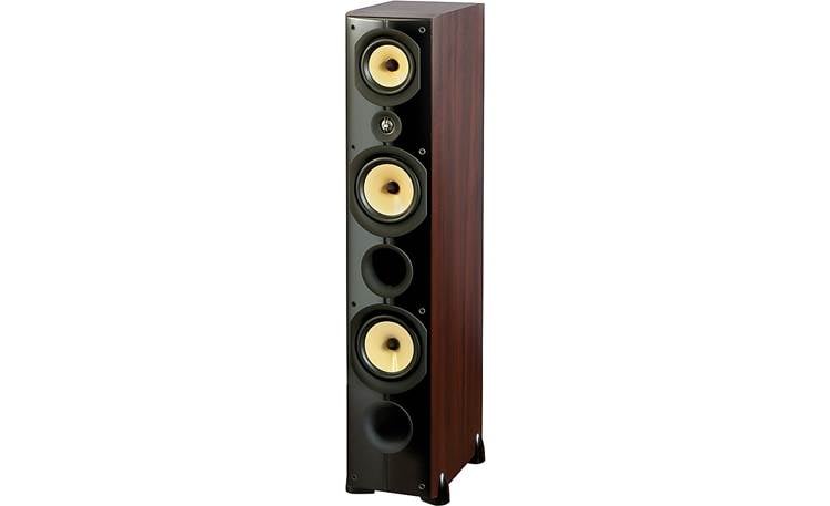

Just completed my 2 sealed subs with Rss390hf-4 15.
I used Russian birch ply for the build.
Painting / polish is pending.
Looking for suggestions / ideas for finishing.
I like the dark cherry and rosenut finish. But not sure if it will come out like I am imagining it :D
My towers have dark cherry finish
This HSU sub has a rosenut finish.
The top of the subs have the plywood layers visible. Not sure what impact that will have on the finishing.
