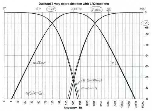

See below pic from Linkwitz While one driver before crossing cutoff point will responding beyond that point too. Same for next driver which start responding before its cutoff and this both create overlapped response area with different amplitude.
At certain point in overlapped region, both drivers have same frequency from different filter of crossover - low pass or high pass. These low-hi pass are built with LRC which changes phase for different leg of crossover for particular driver.
