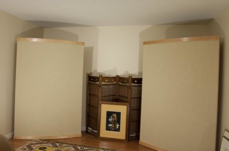

Re WAF, if they every go back by walls again, you can DIY some screens. These are hiding Klipsch Jubilees. You could do the same concept maybe with just a big frame if she might like it better (esp if she helps pick-out the fabric). I say put one on Sadik's list if he'll entertain the idea.

Thanks @grindstone :)
I will keep in mind that DIY screen idea.

Edit: Once used surplus store fabric when needing to grandkid-proof a speaker (it was strong-enough). Cost something like 2-5dB from 2k on up, FWIW. That's when I learned to use 18 TPI linen if it's not too sheer in appearance for your application. The linen, if not available in the right color, can be dyed and might become another "group" exercise so there is mutual investment in it staying. It's not bullet-proof enough for a young kid, but you don't need a new filter, either. FWIW.

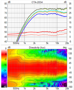

In my MLP 2m away from the speakers, my estimation is that I perceive more of a mix of the listening window response below 3-4kHz and power response curve above 3-4kHz as seen in my MLP measurement below.

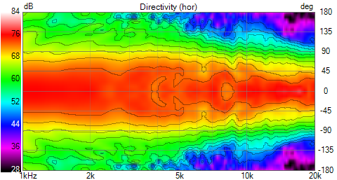

To get rid of all those variations above 2kHz and make it butter smooth is what a waveguide for this tweeter is for, which I am in the process of integrating.. :)
The waveguided tweeter response looks like this (still very wide radiating but controlled radiation).. :)
Now that is one of the things I eagerly look forward to in the coming months. :)
