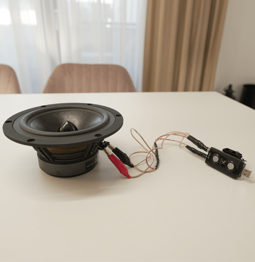

One can measure T/S with a cheap soundcard and simulate in Unibox/Winisd and find out that 12" drivers works well in 15" cube sealed and stuffed. I measure using LIMP on laptop and it works great.
One can also port it to 25Hz for which T/S params are not needed, box volume and Helmholtz resonance (aka box tuning frequency) dont depend on the driver, pls dont get me wrong, to see the frequency response T/S are indeed needed.
Also the simulated response is overshadowed by the room modes (peaks and dips) and the simulated response is lost, though this should not deter to DIY. In fact it is due to this that one needs dual subs and DIY really pays off.
Also, in measurement, we want to see peaks and dips, so the scale of graph must be kept less, with a high scale it give a false impression that response is closer to flat
