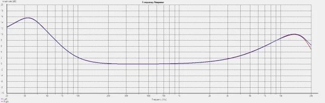

As you can imagine, the 9 small drivers were mainly good only for mid range frequencies. To force them to deliver Low & High Frequencies, an active equaliser was used at the Line In level (Pre amplifier signal level).
The active equaliser provided an Low Frequency Boost of approx 12 dB and a High Freq boost of also 12 dB. The exact amount of boost and the EQ shape varied with the version (Called Series) of the 901 ... I think there were Series 1 to 5 or 6... But to generalise, the boost was approx similar.
Below is a typical, simplified EQ curve.
You can buy an appropriate (depending on your 901 Series 1 to 6 EQ from E-Bay) but a

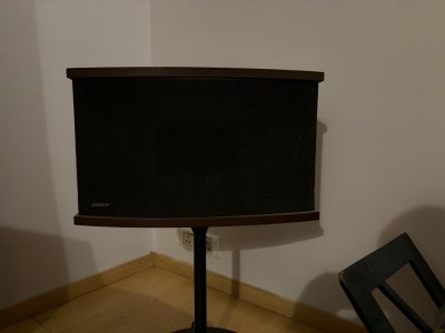

Thanks a bunch for this detailed reply. It is incredibly helpful to know that you have good understanding of this speaker. I am also on the verge of replacing my amp and will take your guidance on the power requirements. I have a question - How do I know which series it is? I looked at the back and on the bottom of the speakers and could not find the model number - series etc. It is on a pedestal like picture below. Should I unscrew the pedestal and see? Also, is it safe and reliable to buy these active equilizer from ebay in India or should I look for one from a different company, since this Bose speakers are at least 35+ years old.
Chipman,
Visually, the speaker Stands point to a Series 5 or Series 6. They are black anodised. However Its not clear to me if you have photographed your actual speaker of posted a typical speaker pic.

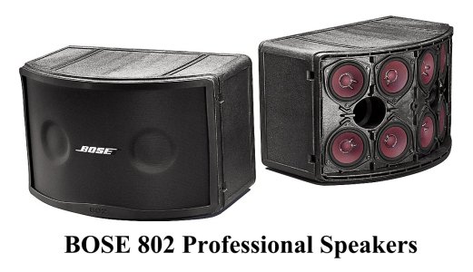

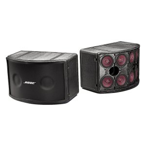

Yes, I agree, the Bose Professional Audio (PA) series are rugged and play Clean & Loud.
As far as I know, they never used foam surrounds ;)
Interesting design features in these (801 series) speakers were:
1. (Like the 901s) No Tweeters ( Tweeters being the most fragile ). In fact No woofers either ... they just used High Power, High Excursion 4 inch drivers.
2. MOST INTERESTING .... the use of a Car Headlamp incandescent bulb in series with the (PA) Speaker Input!
At normal operational levels, the car bulb would remain cool and have only a small resistance. But if Excessive power was delivered into the speakers (eg microphone dropped), the larger current would heat the bulb filament and VERY Sharply increase the resistance in series with the drivers, protecting them. Once the overload is removed, the lamp would go Off & effectively "disappear" from the circuit.
Incidentally, the Resistance of an incandescent lamp typically increases proportional to I^4 i.e. IxIxIxIxI ...
so if the Current Doubles, the Resistance increases 16 Times!
The combination of 1 & 2 made these speakers indestructible.... ( Though the Huge Non Linearity of the incandescent bulb, made them distinctly Non Audiophile fare)

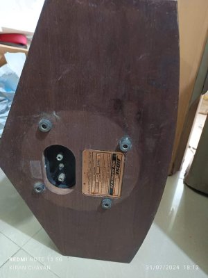

Ah ok. I have a calibration mic and a 901 series 4 pending restoration in trivandrum. Figured if you were nearby....
Check the bottom of the speaker to find out the series. Some of them don't need new surrounds
