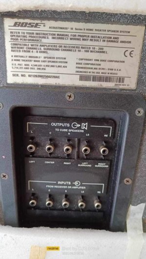

Update: I bought AM10 Series 3 sub, which is in great working condition as well. Now the only question is which avr should I pair it with. Any suggestions? I will be using the speakers primarily with my Samsung Frame TV.
Congratulations. What are the inputs on this sub? Does it come with RCA, speaker level or bose proprietary? This will decide what you need next.
MaSh
It has rca inputs. Picture attached
Thats great. If I remember right, this is a Passive Sub. So you need to connect the Speaker Out of receiver to the Inputs on the Sub. So you would need Bare wire on one end to connect to the Speaker Out on the receiver and RCA plugs on the other end to connect to the Bose Sub.
Look for any receiver that claims to put out over 100w at 8ohms (20-20khz) with atleast 2 channels driven.
You might need these for the speaker wire to and from the sub.
RCA Plugs for Speaker Wire
MaSh
MaSh
Thanks much! Really appreciate it response. However, can you suggest a few receivers for me to filter out? Also, I have a denon avr-x2500h. Would you recommend using that?
You are welcome. Yes absolutely. Go ahead hook up the denon. Now that you are running all speakers through the Bose sub, mark them as Large.
