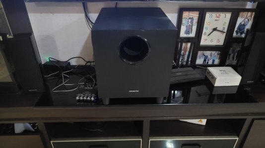

Update...
Got the setup working.
ZK-MT21 for 700 and 450 for 24v, 5a adapter. Total cost of 1150.
Reused: L and R Speakers, Subwoofer, Speaker Cables, 3.5 mm cable.
Descent sound. Bluetooth enabled. Control of Master volume, Subwoofer volume and frequency.
Overall, very happy with the result.
