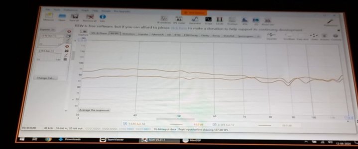

Attaching in room response for multiple subwoofers measured in REW.I bet you wont find with anyone in our Country. People share their setup but they dont share their in room Response. I am sharing for my forum members the ultimate knowledge.

More details of your set up please ?
And a picture of the room would understand the context of the nice measurements too.
I got it calibrated from a professional. This is one of my friends room which was calibrated. This room had 8 subs 15 in in the back for near field effect and 2 subs 18 inch below the screen. All powered by best of the best amps crown Itech 12000.

Sir, just a small thing. When you say screen shot. It means an a actual screen capture. You've taken a horrible image of a computer screen. On zooming in you can't even see the measured response below 30hz
Wait a while next calibration is due ( in 1 to 2 days) will share room response for 17Hz to 20,000 Hz with the receivers we have. This will be denon 3700H. Thanks for patience

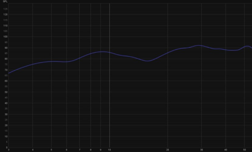

I shall oblige. Here is a screenshot of my in-room response for 2 x 10" subs without any calibration or EQ - smoothened to 1/6th.
