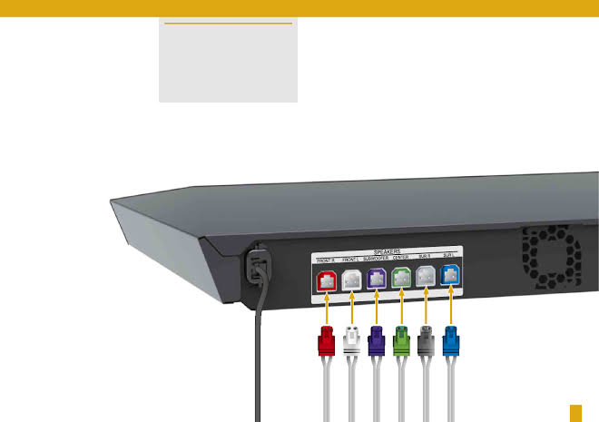

Well it will not be easy and also you cannot hook up the usual HT center channel speakers to your Sony. You could check with service center if they have a Center speaker from a high end model. You need the wire connector pins to match if you do not want into the cut and join direction.

Simple. Check the model's spec on page 61 of the manual. Its giving out 40w at 3ohm at 1Khz. What do you think it will give out at 6 or 8 ohms which the usual speakers are rated at?
